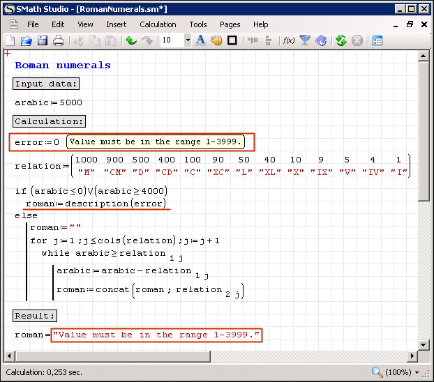

Another step performed: now one can compose worksheets with localized text within expressions using description(1) function! See the screenshots below (note, Description for error variable set in different languages, as Descriptions supports multilanguage).
Figure 1: File opened on PC with US local.
Figure 1: File opened on PC with Russian local.
P.S.: Will be available in next SMath Studio release.
It's a very useful improvement.

A bit more regarding description(1) function (it will also support description of the built-in functions/variables/units):
Suppose it could be convenient to use it at least in learning purposes.
