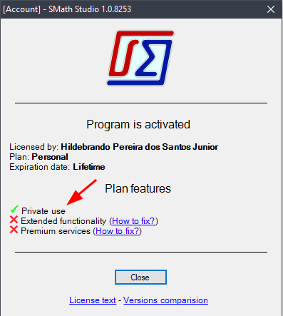

Dont forget the "Details" screen.

Thank you uni; it is beneficial to understanding the driving cause for the changes in the EULA.
However, I believe rex he was making a comment to the effect:

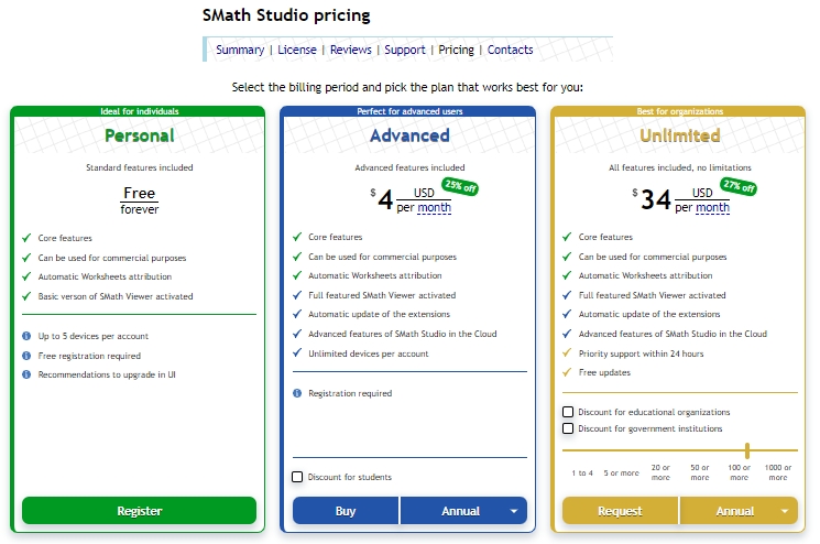

  • The Pricing https://en.smath.com/view/SMathStudio/pricing; features the "can be used for commercial purposes"
  • Per https://en.smath.com/view/SMathStudio/license; "SMath Studio is free for private use. The capabilities of the program and its scope of application can be expanded by purchasing additional services associated with a personal account;"
  • per the EULA (english) installed/accepted via the actual install:, "SMath Studio is free for private use. The capabilities of the program and its scope of application can be expanded by purchasing additional services associated with a personal account;".
If we want to use SMath for commercial purposes, we are left with the dilemma that the actual EULA only mentions private use (and infers commercial/educational uses might not be authorized). It would be nice if commercial use, and the limitations thereof, are included in the EULA.

Hi Kenny. As far as I understand, to be able to use it for commercial purposes (and I guess academics too) you only need to register it, and not install it with that account on more than 5 computers, as can be read in the green option in https://en.smath.com/view/SMathStudio/pricing
What I do assume is that in each of these installations you need to log in so as not to violate the conditions of your purchase, free but with registration needed.
That is, if you use it without logging in, you can still use it for personal, but not for commercial purposes.
I think it's not, when we log in the details show private use... Where I work, I had problems because of the license agreement. The IT department demanded that I remove Smath Studio.
For now, the only solution is still using any version before 7822.
