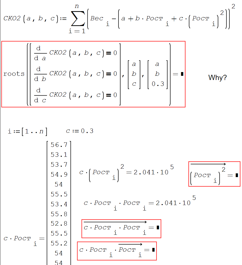

Why I have errors? - See please the attached file - Messages
#1 Posted: 10/14/2023 3:31:44 PM
#2 Posted: 10/14/2023 9:38:32 PM
WroteSee please the end of the attached file.
Triplet roots ... FindRoot not doctored.
6-1-Mister-Class (1).sm (66.16 KiB) downloaded 1316 time(s).

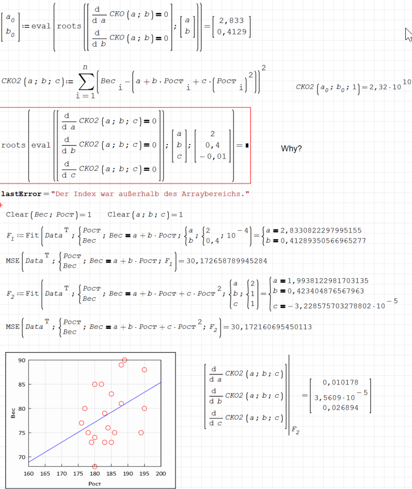

#3 Posted: 10/14/2023 9:42:14 PM
The first error can be handled by wrapping the function in eval(). For the second one this does not help.
I take the opportunity to advertise the Maxima Fit() function.
It is explained in https://doi.org/10.25933/opus4-2949 chapter 6 (English) and in https://doi.org/10.25933/opus4-2948, chapter 9 (German).
6-1-Mister-Class Kr.sm (56.11 KiB) downloaded 1353 time(s).
![2023-10-14 16_31_26-SMath Solver - [6-1-Mister-Class (2).sm_].png](/en-US/files/Download/BgD2UF/2023-10-14-16_31_26-SMath-Solver---[6-1-Mister-Class-(2).sm_].png)

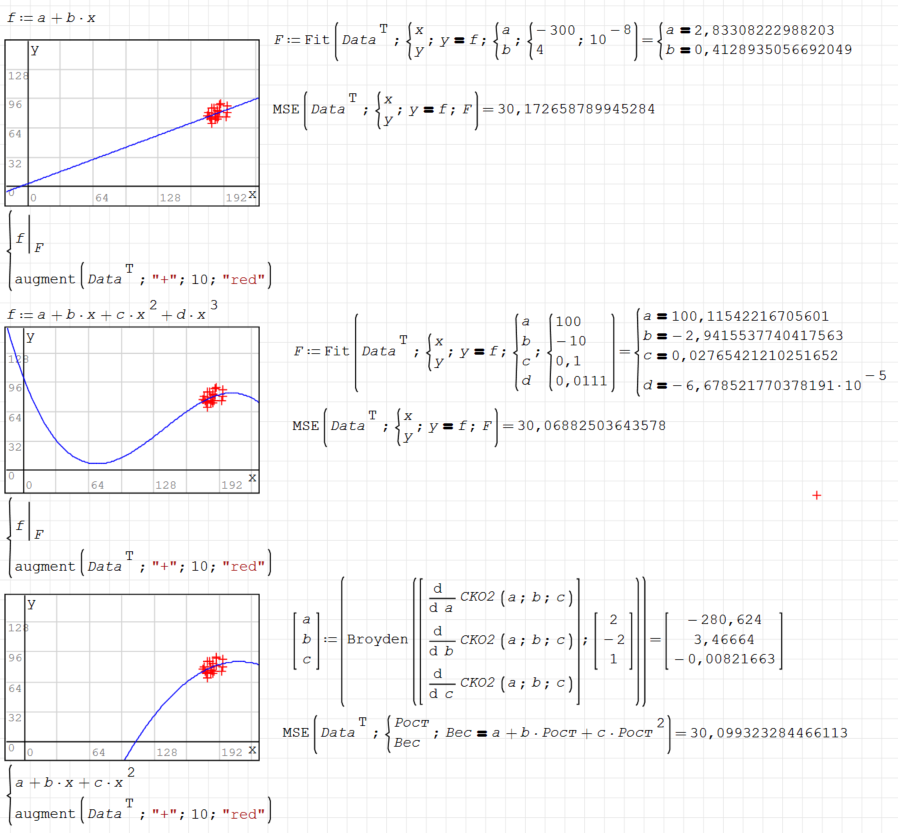

Hi. Polynomial fitting, returning the same values that Excel returns. From this post.
fit_CKO.sm (51.22 KiB) downloaded 1405 time(s).

Hi Valery. Martin showed why. But for the quadratic case Máxima's Fit function does not return the same result as Excel, which could be said to have been taken as standard, since they are also the same as those usually obtained with the 'all powerful' (talking about of gods) a\b of Matlab. I made the post to show how those mythical values can also be obtained in SMath.
Because SMath' solver isn't very powerful you can get those same values with your method using another, like the following one
About the error vectorizing, you can see why taking a look of this
Valery Ochkov 10/15/2023 8:03:00 PM

#11 Posted: 10/15/2023 11:25:44 PM
There is not much sense in fitting functions with many degrees of freedom to data containing not much information. Any function which goes through the centroid of the data points will come up with a similar MSE.
Is the second result really the best just because of it's lowest MSE?
![2023-10-15 18_24_01-SMath Solver - [6-1-Mister-Class Kr.sm].png](/en-US/files/Download/nAW8yY/2023-10-15-18_24_01-SMath-Solver---[6-1-Mister-Class-Kr.sm].png)

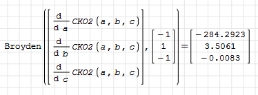

Thanks Alvaro for the robust Broyden.
Curious, Solver 30405 Slope/Intercept back on foot.
6-1-Mister-Class (1).sm (65.74 KiB) downloaded 1310 time(s).

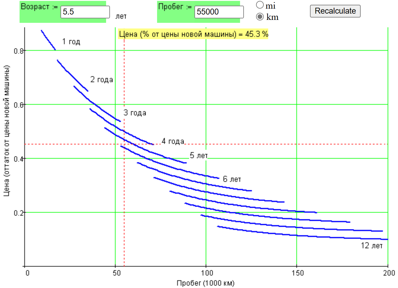

And what about 3D fitting in SMath?
See please my old problem in Mathcad
http://twt.mpei.ac.ru/ochkov/car/c_e.html
Online calculation
http://twt.mpei.ac.ru/MCS/Worksheets/old-car.xmcd
Online calculation

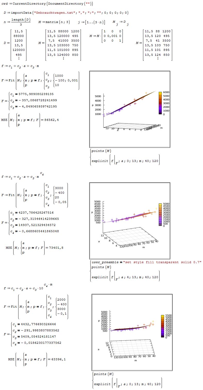

#14 Posted: 10/16/2023 5:57:28 AM
The second and third fit aren't really robust (quite some dependence on initial guesses)
Gebrauchtwagen.txt (729 B) downloaded 963 time(s).
Gebrauchtwagen.sm (90.47 KiB) downloaded 1378 time(s).

#16 Posted: 10/16/2023 12:48:56 PM
WroteAnd what about 3D fitting in SMath?
Online calculation
Another way, from the same previous post .
fit cars.sm (83.96 KiB) downloaded 1386 time(s).
#17 Posted: 10/16/2023 1:45:10 PM
#18 Posted: 10/16/2023 3:32:33 PM
WroteWunderbar!
Send me please the M matrix as sm-file!
The data is from your website. I copy-pasted the table to a new text file and imported it. Just use the files provided in my post.
As to the last plot: I guess the mileage limits of the individual lines are taken from the minimum and maximum slope observed in the age-mileage plot (fig.2 in your reference)?
Do you see any particular problem or do you just want the work getting done?
#19 Posted: 10/16/2023 6:38:46 PM

#20 Posted: 10/17/2023 12:58:58 AM
Global fit Cholesky
Frequently, you can manage the Phi vector for a best regional fit.
Project fit cars Cholesky.sm (19.75 KiB) downloaded 1348 time(s).
