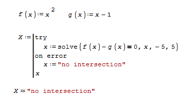

One option is as follows:
However, the error might still be due to something other than a non-intersection.

Thanks a lot for your answer .
I'll start from it to buil my solution ; in the reality the segment is the operating line of a Cooling tower (that is a segment in the Merkel model) and if the operating line intersect the curve of the Entalpy of the Moist air means that the operators in the field have incorrectly taken the data about the Inlet and Outlet Water temperature and/ or of the Inlet and Outlet Wet bulb temperature of the Air( it is enough that one of these 4 data are wrong and the results are messy).
I'll try to put this error message in a conditionally formatted Text(Label) to be more explicit in its description so that it is easier from a point of view of an operator to understand what is happening (together with a graphical rapresentation of the whole)
Thanks again and best regards ( and sorry for my poor English)
Franco

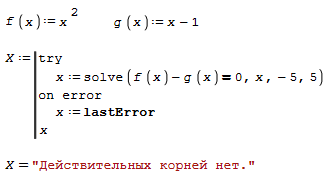

#4 Posted: 9/29/2024 3:52:29 PM
1,540 likes in 1,854 posts.
#5 Posted: 9/29/2024 5:23:31 PM

Thanks a lot uni, now need to put everything in a conditionally formatted label and check the type of output if is a string or a number(s) to change the displayed message.
Franco
