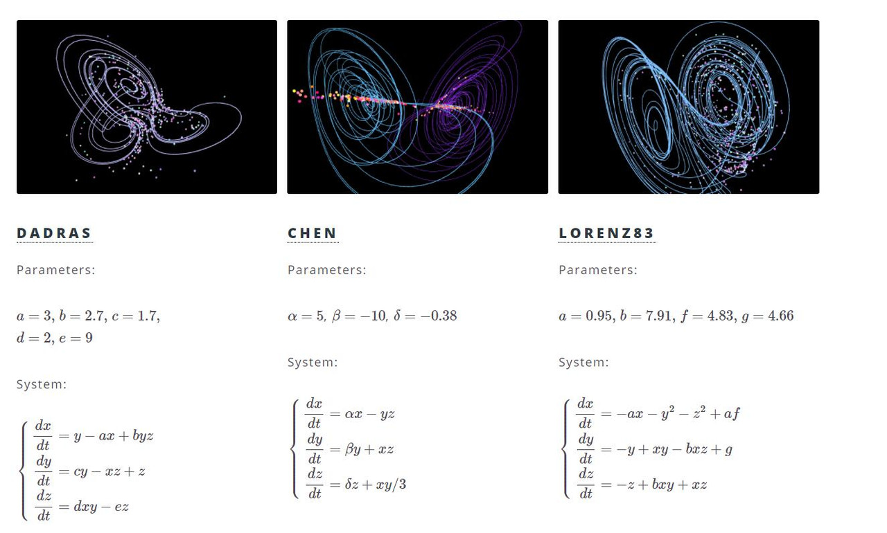

How to get explict parametric function, like x=x(t), y=y(t), z=z(t) from above equations?

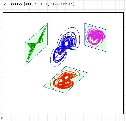

Hi. For show the four plots at once.
DadrasAttractor.sm (46.22 KiB) downloaded 1201 time(s).

Thanks for the 3D image
Now it is possible.
Dadras Attractor.sm (20.15 KiB) downloaded 1183 time(s).
The Aizawa Attractor.sm (21.51 KiB) downloaded 1164 time(s).
Click to enlarge Click to enlarge
