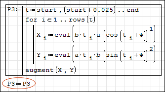

I've checked your worksheets and see one place for simple optimization applicable for most of them.
Often you use procedures to draw static set of points for all frames of animation. Procedures (when line is used right after the definition operator) calculated on every call - SMath Studio do not precalculate their values.
So, you can speed up calculation simply by line like this:
This line asks the program to calculate procedure and store its values into the initial procedure variable. So, we have only one calculation of static shape for the whole animation!

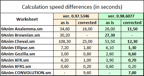

I've corrected your examples according to the hint above and tested them in both versions: 0.97.5346 - the one you have used to create files and 0.98.6077 - the latest nightly build. Here are the results:
Final versions of the worksheets:
