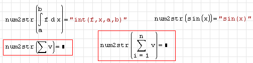

num2str() fails to convert a sum to a string. In the sum(1) example "syntax is incorrect", in the sum(4) example "n is not defined".
Edit: This is now BTS issue SS-43
#2 Posted: 8/24/2013 3:48:22 AM
127 likes in 342 posts.
I confirm and add some further example.
[albumimg]284[/albumimg]

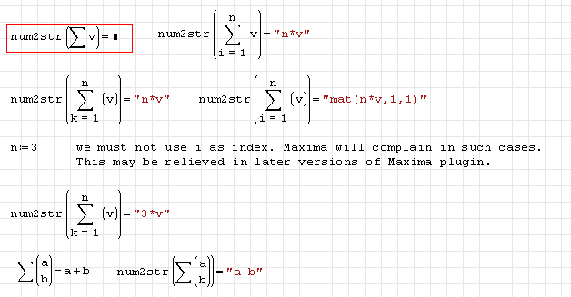

This is the current state. sum() now can produce symbolic results.
num2str() should provide a string corresponding to the unevaluated expression if it cannot be evaluated.
