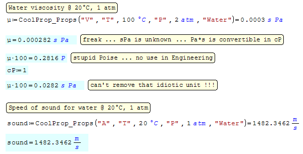

From design or else wrongdoing the built-in unit system should
be evaporated to avoid idiotic results.
I Consulted for years with my Ti-58/59 w/o units.
Inst_Viscosity Water.sm (43.72 KiB) downloaded 1548 time(s).

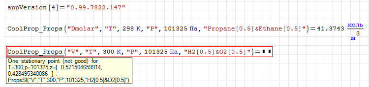

Authors: Davide Carpi and Mike Kaganski.
Plugin updated, but now the error is different:

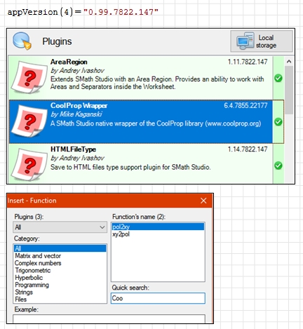

Hi Viacheslav. After a clean SMath installation, coolprop don't appear as defined function. My windows is 32 bit, do you have where to check that?
Thanks in advance.
#9 Posted: 7/5/2021 1:30:30 AM
1,558 likes in 1,868 posts.
It's true, functions are not loaded. I have tested the plugin with local build. Something goes wrong when building on the server. I asked Andrey about it.
