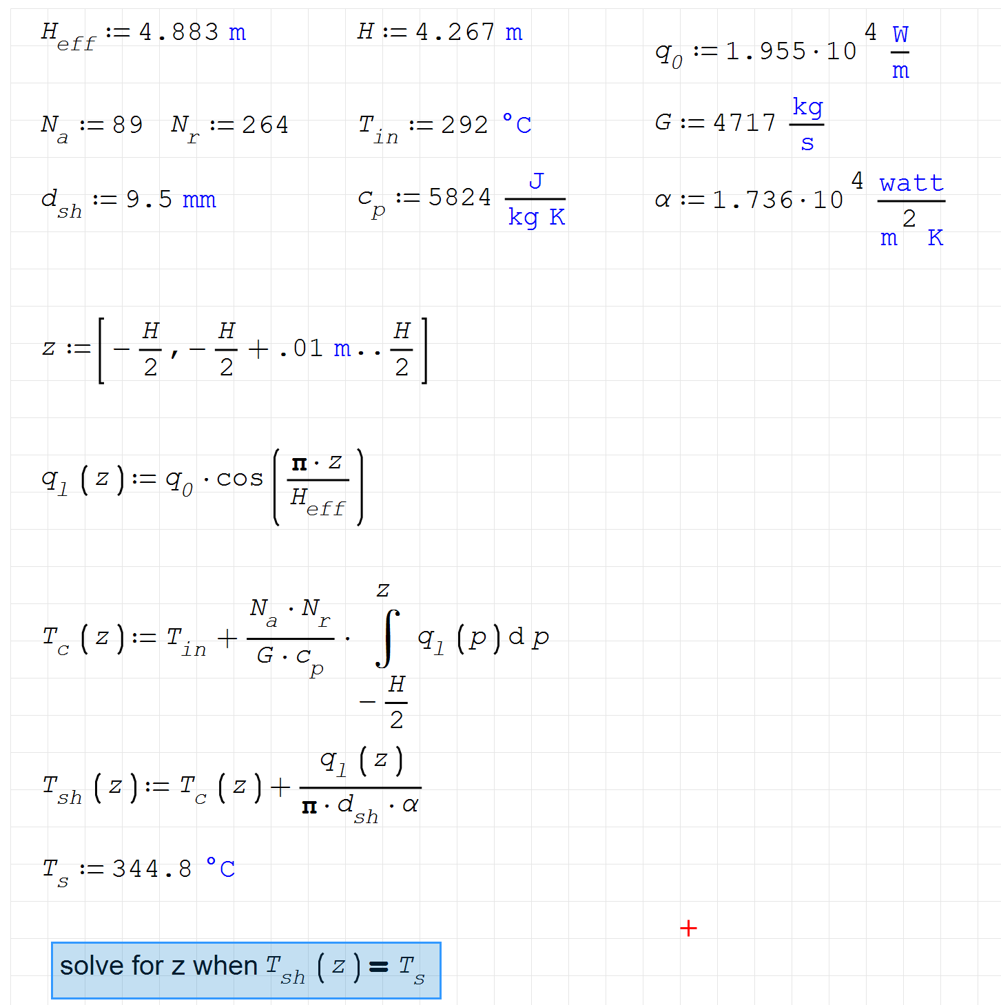

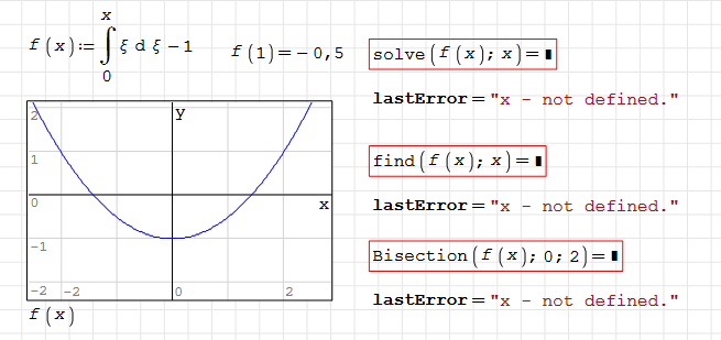

Good day!

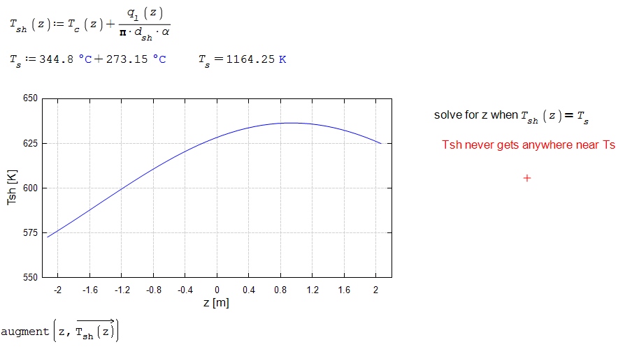

I was a Mathcad Prime user but I am currently trying to learn SMath and importing my calculations in it. It was easier in Mathcad but somehow I'm stuck when doing this part regarding solving equation that involves units, a range, and integral, and graphing the plots
I would really appreciate if someone could help me with my problem

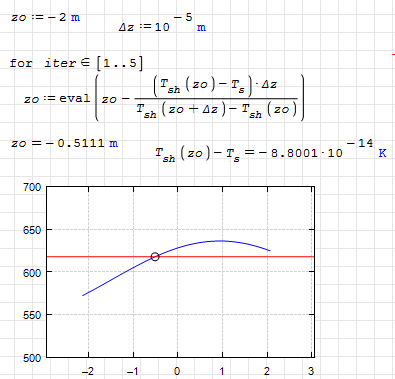

Hi. You can try using some ad-hoc Newton-Raphson method.

#5 Posted: 9/9/2025 3:36:27 PM
@mule You are right! It's what SMath returned, and I didn't do a sanity check! Of course, SMath understands units - I'm obviously half asleep today!!
I simply wrote a simple Newton-Raphson solution in the attached.

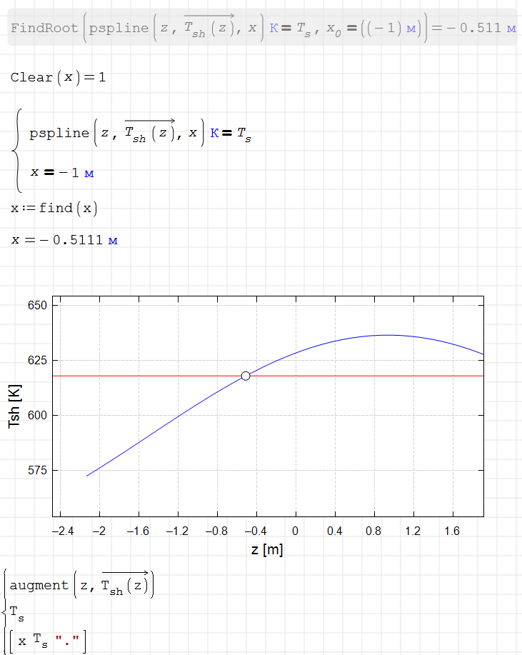

Sometimes just sampling and interpolating the function helps.
solver_b_Kr.sm (21.06 KiB) downloaded 1360 time(s).

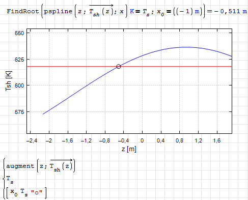

#7 Posted: 9/9/2025 8:28:06 PM
Funny workaround. Other solvers are now available.
solver_b_Kr_uni.sm (23.2 KiB) downloaded 1297 time(s).

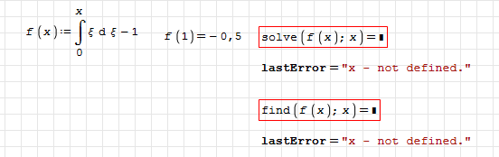

#8 Posted: 9/10/2025 6:33:48 AM

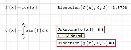

Is anyone able to explain, why the function can be evaluated in the context of pspline but not in the context of a solver? Looks like a really big problem under the hood, otherwise could have been fixed long ago.
Edit: Part of the problem is throwing pointless error messages. The unknown variable MUST be undefined in solver calls.

#9 Posted: 9/10/2025 8:13:30 AM
I can make an assumption that the integral with a parameter in the upper limit works only for numerical calculations, and is not supported for symbolic transformations.
#10 Posted: 9/10/2025 10:27:08 AM
As far as I understand, all solvers are numeric procedures, except roots(), where I suspect that it tries to determine the gradient symbolically. Even the gradient-free Bisection() fails. Here I can't understand why any symbolic evaluation should be required.
#11 Posted: 9/10/2025 10:54:31 AM
In fact, when implementing a function in a plugin, you have the opportunity to do preliminary transformations before the actual numerical calculations begin.
Very rarely is the implementation of a function purely numerical. Moreover, for any functions that accept expressions, the implementation always contains symbolic transformations.
Look at how the pspline function is implemented
It is a completely numerical function, since it works with scalars. It does not perform symbolic transformations and when it is necessary to calculate an integral, it becomes defined with specific limits in the form of numbers. The equation solver sees an unfamiliar function and simply assumes that it works.

WOW! it's exactly as what I did with Mathcad Prime. Thank you very much for this tip. I'm definitely using SMath from now on
WroteFunny workaround. Other solvers are now available.

WroteAs far as I understand, all solvers are numeric procedures, except roots(), where I suspect that it tries to determine the gradient symbolically. Even the gradient-free Bisection() fails ...
Hi Martin. The "symbolic" part in all the solvers in the NonLinearSolvers plugin is Unknowns. You can see from Bisection's syntax that it has to use it to determine which is the independent variable. In other words, if Unknowns fails, the solver fails too.

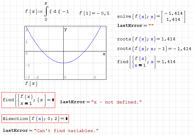

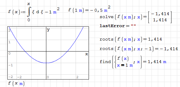

Alvaro, I see that Unknowns() just is not smart enough. Yet, this does not apply to the solvers which do not need to guess the names of the variables,

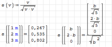

Viatcheslav, you pointing to the scalar nature of the argument (the third one) of pspline() brought an argument to my mind that I once had with Andrey. I complained that SMath doesn't perform some symbolic simplifications (see screenshot below) and the essence of that discussion was that Maxima assumes unknown variables to be scalars, while SMath doesn't do that. Andrey insisted in not making the scalarity assumption by default.
Yet, there is a way in SMath to declare a variable as scalar: you have to tag it as unit.

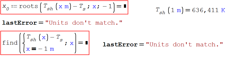

And indeed, this trick does the job for solve() and roots() and find(). Yet I consider this rather being a hack than a solution.
First, you frequently have naming conflicts with pre-defined units.
Second, I can't explain to the reader, why a solver which anyways can't handle anything except scalars (like solve()) doesn't make that assumption by default.
find() seems to have the best unit handling. The unknowns are allowed to have units and be tagged as units. Yet, having the scalarity assumption in it by default, would be a dream.
