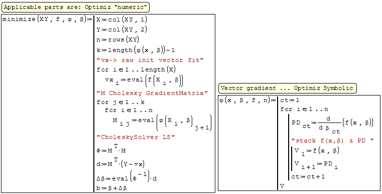

#4 Posted: 6/30/2016 7:50:51 PM
Error code confirmed in your version: "x no definido"
most probably in the collapsed φ(x,β,f,n).
In this module: try this => φ(x,β,f(x),n). If it does
not work ... would be disaster. The most of its power,
Smath 5346 is the "algo style" coding similar to Mathcad 11.
Similar error code may reflect in minimize(XY,f,φ,β).
#5 Posted: 6/30/2016 8:51:17 PM
Using trace() seems that transpose() now holds a symbolic expression if applied in the form f(...):transpose(f(...))); this makes impossible to obtain a numeric result for length() and then proceed in computation of stuff related to k inside minimize; according to Andrey's comments of SS-2335 I suppose is one of the different behaviors of functions able to handle undefined data (like transpose).
You have 2 solutions in current 0.98:
  • in this case you can simply remove the row φ(x,β):transpose(φ(x,β));
    φ(x,β) is a vector and for calculations inside Jean's minimize() there aren't reasons to have it transposed, since linear indexing is used inside these loops);
  • a more general solution (f.e. if you need transposed vector for matrix multiplication) is to assign the transposed function to a function with a different name: φT(x,β):transpose(φ(x,β))

#6 Posted: 7/1/2016 12:08:35 AM
You are right Davide: in minimize(XY,f,φ,β) both lines
f(x,β):=f(x,β) & φ(x,β):=transpose(φ(x,β)) are redundant,
must be removed.

#7 Posted: 7/1/2016 12:36:59 PM
CBG
CBG
78 likes in 312 posts.
Renaming " φ(x,β) " to " φT(x,β) " as indicated Davide , the problem is solved.

#8 Posted: 7/1/2016 9:32:28 PM
Carlos, Davide:
Here is the maths of "HyperSineCosine". The two lines in question
Have nothing to do in there Smath 5346. I know who put them first
in the module, guess: Jean ! Works fine in Smath 5346.
Interesting to cross check in latest Smath.
