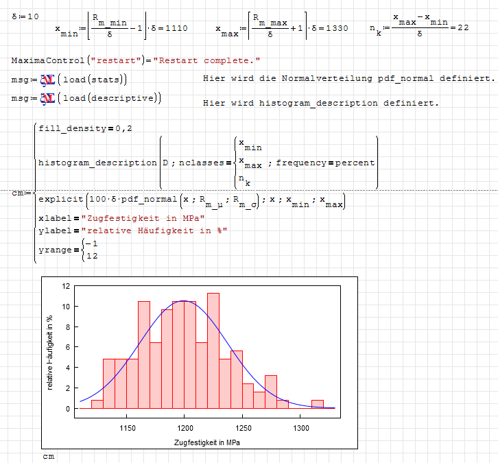

Here is an example adapted from a book on materials science with mathcad, using the maxima plugin and loading additional maxima packages.
Streuung.zip (20.91 KiB) downloaded 445 time(s).
