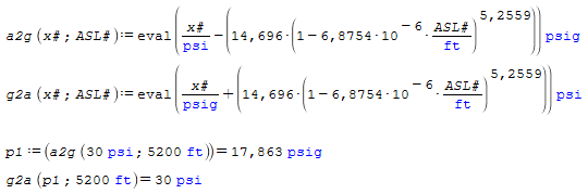

Let the psi unit be psia and introduce an undefined unit psig with appropriate conversion functions.
This approach prevents you from mixing both types of pressure representations, because you would get a unit mismatch error.
It doesn't, however, prevent you from adding psig values, which might not be a good idea.
All in all this is a conversion very much like between K (absolute) and °C (gauged), just with the nasty difference that the offset isn't constant and has to be specified whenever a conversion is to be done.
psig.sm (5.42 KiB) downloaded 1416 time(s).

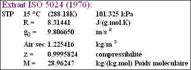

The point you missed is that ISA defines Air @ "Standard Temperature vs altitude"
From recollection, this standard temperature is taken up to 11 km [-56.5 °C].
It is linear from sea level [visit Wikipedia ...]
The region around 11 km [Tropopause] is unstable.
Then, you have to correct for you local day by day °C.
Mexico city is ~ 4 km altitude ... some Incas leave up to 7 km altitude.
