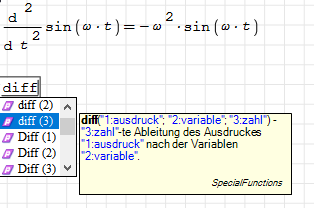

Is there the Derivative the 2-d order in SMath? I see only 1-st order.
Thanks!

It is not in the side panel but you can select it in the dynamic assistant or in the Insert functions dialog.

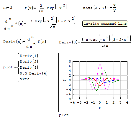

#3 Posted: 5/29/2023 8:54:18 AM
As well, you can have multiple derivatives.
f(x) is the integrand of erf(x)
Cheers ... Jean.
