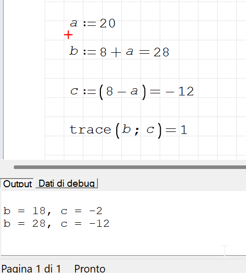

It could be interesting to implement a plugin that allows me to mark a variable located anywhere on my sheet and monitor its value while I change another variable elsewhere. For example, when designing, approval values are often at the end, while the main input is at the beginning. Every time I need to see how a change affects the variable of interest, I have to scroll all the way down to check it, which makes the process very tedious.
#64 Posted: 2/12/2026 4:31:07 PM
127 likes in 342 posts.
(#63) Alex,
For now, you can use the trace() command and launch the debug window with F11.
ioan92 2/15/2026 1:08:55 PM, Davide Carpi 2/12/2026 7:01:57 PM

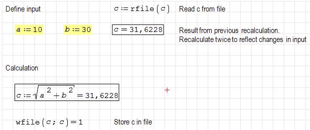

#66 Posted: 2/13/2026 12:35:57 PM
1,353 likes in 2,264 posts.
This is also an option. It avoids absolute variables, which are a nightmare to type with a german keyboard.
Yet it relies on double recalculation after changes in input.
