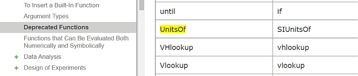

#3 Posted: 1/21/2021 3:35:47 AM
1,127 likes in 1,799 posts.
I need the following to output 4 as I'm trying to cancel out the units for a function using the variable. ...
Hi. I think that SMath's UnitsOf() it's well defined, not like the equivalent in Mathcad, which it's deprecated
and substitute by SIUnitsOf(), even the Mathcad error was related with the default unit system setup (SI=MKS, FPS or CGS): https://support.ptc.com/help/mathcad/en/index.html#page/PTC_Mathcad_Help/example_explaining_SIUnitsOf.html
As I underdestand, you want to recover the unit of a variable for plot in that unit as axis scale. But I guess that for that you must to write a 4 parameter version of your function: Plot(x,y,f(2),UnitForX,UnitForY)

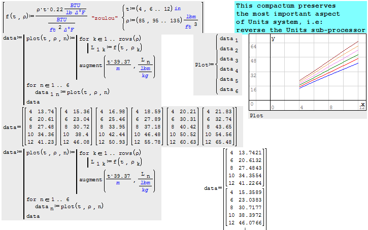

#7 Posted: 1/21/2021 1:50:07 PM
Ruben Sidranski
Ruben Sidranski
17 likes in 465 posts.
Jean,
Your example is more detailed than mine, showing the same thing. In your case, you multiplied t by 39.37 for the conversion to inches. My intent was to "normalize" and just use the root variable to eliminate the units.
This appears to not be possible and I will just continue to define var1:=#var/units. The function is working on multiple equations, this would have been the "cherry on top".
Thanks to all for looking into this
#8 Posted: 1/21/2021 5:19:25 PM
Jean,
I you have to invent a particular reverse-Engineer for an odd application,
may as well not use units, that will solve all cases.
Or, more wisely convert before hand to SI, unfortunately here,
°F, °K don't exist ... what !
No, they don't exist ... latest ITS-90 have normalized only few fixed points.
Not in °F, °K ... in °C.

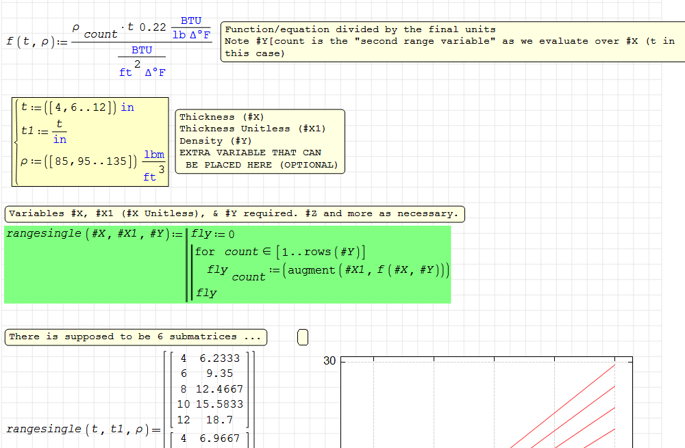

#9 Posted: 1/21/2021 5:33:21 PM
Ruben Sidranski
Ruben Sidranski
Jean,
Let's take a step back and look at the Heat Capacity sheet.
This is the one you could not open, so I'm posting the revised function below. In this example (you have your sheet to look at), I just want to eliminate the variable #X1 as all it is is the variable #X unitless. As mentioned above, I just "defined" #X1 as #X/units and we are fine. I am updating calculations to use this "generic" function for consistency. I was just hoping to eliminate having to define #X1 as a separate variable ...

#10 Posted: 1/21/2021 10:26:31 PM
Jean,
My screen is so small for so much !
You can design your own compactum.
#11 Posted: 1/22/2021 12:35:12 AM
Ruben Sidranski
Ruben Sidranski
The intent of this thread was to find a built in function to to eliminate the units (my misunderstanding of UnitsOF()). In your screenshot, you have a multiplier ... in this case, 39.37. This is what I'm trying to avoid for other equations that might be in BTU. or FT, or "widgets". Lets move on to bigger items. The simple fix is to define #X/units (t/in in this example).
