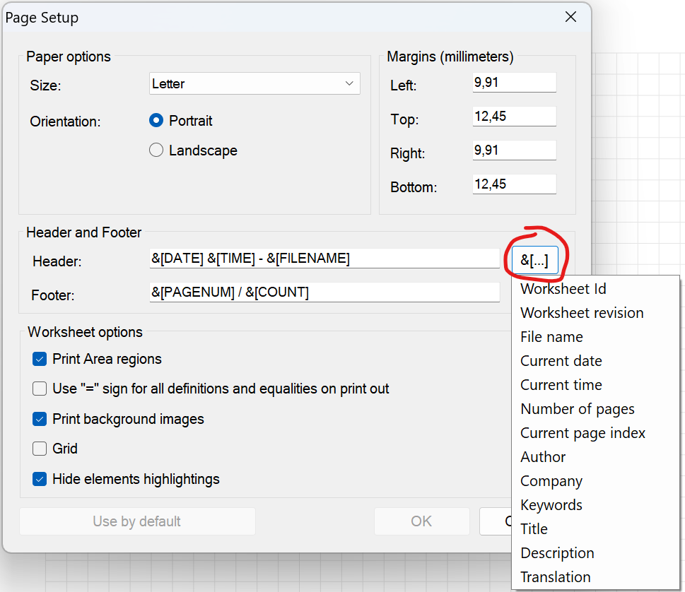

Can someone help me understand what these new improvements do:
Page Setup dialog improved to allow selecting available substitutions from the dropdown lists for header and footer;

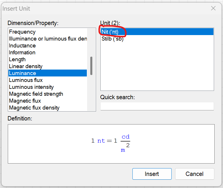

The non-SI nit unit of measurement added to the Luminance dimension;
It is about these buttons:
New unit of measurement added:
