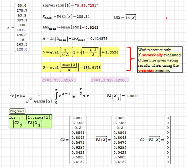

Observed same problems even after a second Clean re-installation of 7251.
Consequently, I noticed that the Vectorize operator works correctly
when eval() function is used to evaluate alpha and beta of the Gamma function.
Otherwise, it gives incompatible results.
Has anybody experienced this issue?

Hi Nugegodage. I slightly modify your file, putting eval only where Mean appear. What I see rigth now, with your new file using eval, not before, is that there are not bug, and the "bad results" are because Mean can't be vectorized (or better say, isn't a good idea vectorize them), like any other function that take vectors or matrices as arguments.

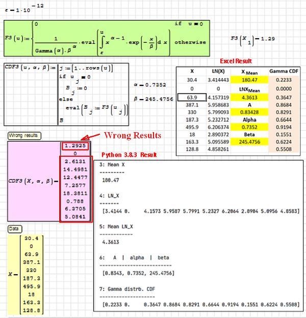

A few more issues please.
Gamma_CDF_Error_Wrong_Results.sm (334.88 KiB) downloaded 1547 time(s).

Freak 7251 does not open !
You just have two values: α:=0.7352, β:=245.7456
That's enough to simulate/evaluate CDF.
CDF Gamma.sm (262.81 KiB) downloaded 1465 time(s).

Sorry. PDF attached. Thank you Jean!

#37 Posted: 5/20/2020 10:46:24 AM
Ordinary Simpson is inadequate [too steep PDF, too long X's]
Romberg/Simpson algo style is just perfect.
All done in gray attached.
Cheers mon Ami from so far away !
CDF Gamma.sm (277.8 KiB) downloaded 1456 time(s).
