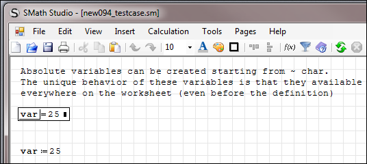

New feature is introduced in SMath Studio 0.94.4535 - Absolute Definitions.
The same is for functions (which starts from ~).
This feature is not the same as used in Mathcad (called Global Definitions). Absolute Definitions designed to introduce a built-in way to send data from the bottom of the Worksheet to it's top.
Example: absoluteDefinitionsExample.sm.
Any questions are welcome
Best regards, Andrey Ivashov.

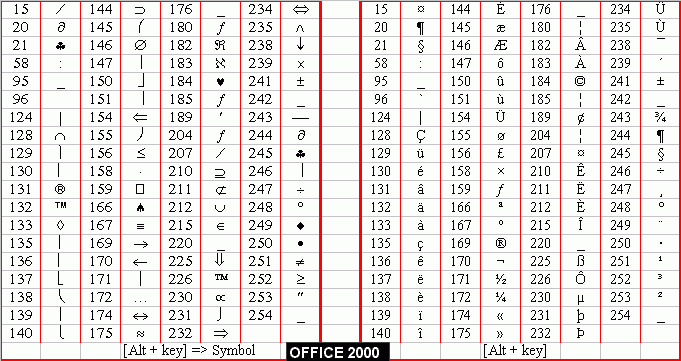

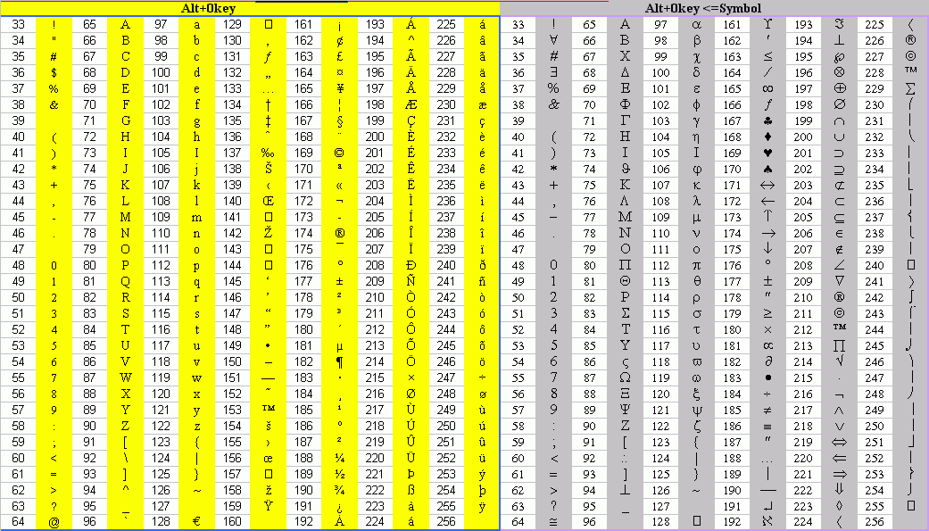

#11 Posted: 2/16/2016 11:42:04 AM
Smath recognises Alt+0key, but not Alt+0key symbol.
Smath does not have the "Font" plugin
Still very interesting for publishing.
