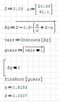

I need to get the RayLeigh Damping factors alpha and beta using two frequencies, so two simple simultaneous equations should do it. tried using Solve but no luck.
Does anyone know why it is not solving?
Thanks in advance

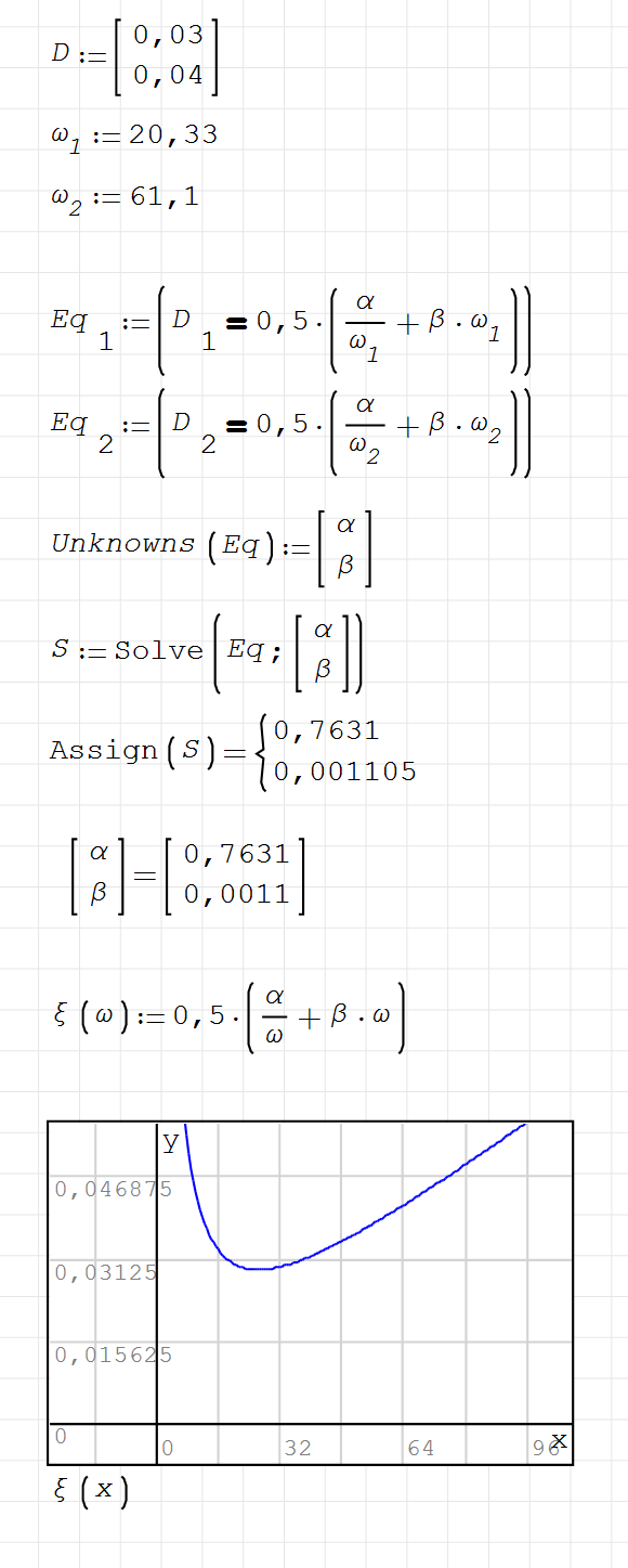

#3 Posted: 4/5/2022 6:24:50 PM

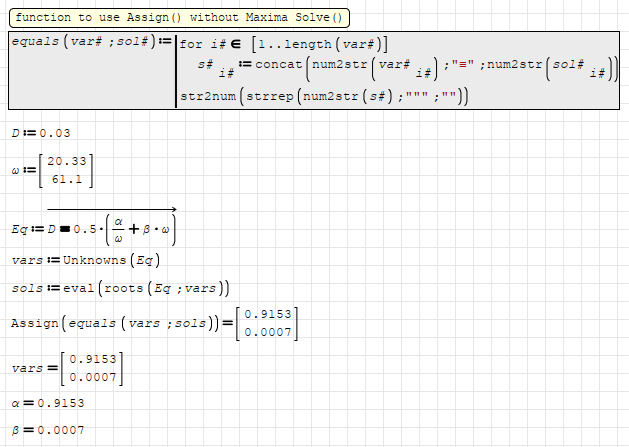

You can use roots() for your function. And a vectorize() can simplify it.
However, to use Assign() you will need this function to merge vars and solutions.
Assign_without_Maxima Solve().sm (7.36 KiB) downloaded 1334 time(s).

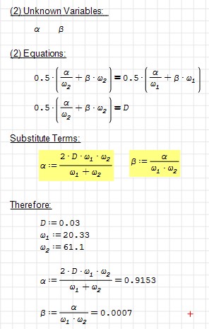

#5 Posted: 4/6/2022 10:28:07 AM
Greetings,
Another approach would be to use some elbow grease, you can substitute terms by hand and solve for 𝛼 and 𝛽:
Keypress (You can copy/paste the following into your worksheet):
*NOTE: ω.1 and ω.2 shown above are variables with subscript, they are not vectors ω[1 and ω[2; You should be able to substitute ω.1 for ω[1 if that serves your purposes.
- - -![[SMath] Simultaneous Equations.jpg](/en-US/files/Download/23FW8Q/[SMath]-Simultaneous-Equations.jpg)
- Kenny Lemens, P.E.
α:{2*D*ω.1*ω.2}/{ω.1+ω.2}
β:α/{ω.1*ω.2}
Mo 4/6/2022 11:57:00 AM

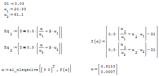

If the damping coefficients are denoted by α1 and α2, you can use the function al_nlegsoive
test.sm (6.99 KiB) downloaded 1351 time(s).

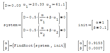

#8 Posted: 4/7/2022 1:43:03 PM
... more in there from native Smath code.
Solve FindRoot FORUM.sm (10.9 KiB) downloaded 1330 time(s).

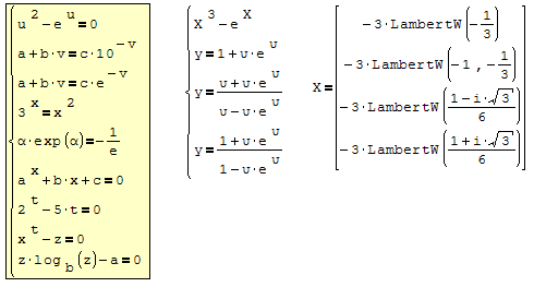

#9 Posted: 4/7/2022 5:27:55 PM
solving with uni's latest addition mathcad blocks;
you wouldn't need Eq: actually, but it can be shown.
mathblock.sm (5.15 KiB) downloaded 1330 time(s).

#10 Posted: 4/7/2022 6:19:34 PM
I think this is the most sophisticated method of my way.
It can get unknowns from equation, solve them.
In the end assigns numerical values to unknowns.
You don't need to define alpha or beta or any variable.
All process is automatic.
mathblock_v2.sm (5.19 KiB) downloaded 1341 time(s).
There is also this way for guess define.
#11 Posted: 4/8/2022 2:19:42 AM
WroteI think this is the most sophisticated method of my way.
This is good, but for a system of linear equations(our case), the guess can be arbitrary.

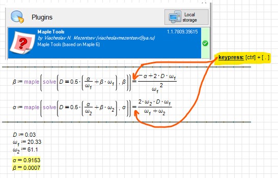

#13 Posted: 4/11/2022 9:57:44 AM
Greetings,
If plugins are considered, you can also consider the use of Maple:
- - -![[SMath] Maple - Simulatneous Equ..jpg](/en-US/files/Download/yzzGBF/[SMath]-Maple---Simulatneous-Equ..jpg)
In the image I posted, the 'equal sign' shown on those two equations are actually symbolic equals; keypress: [ctrl] + [.] instead of keypress [=].
Kenny Lemens, P.E.
Kenny Lemens, P.E.

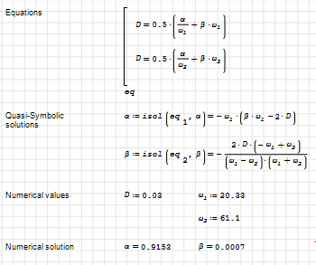

#14 Posted: 4/11/2022 4:44:08 PM
Hi. The isol solution, using only the Mathcad block plugin.
isol_example.sm (68.13 KiB) downloaded 1279 time(s).
isol_example.pdf (34.57 KiB) downloaded 741 time(s).
