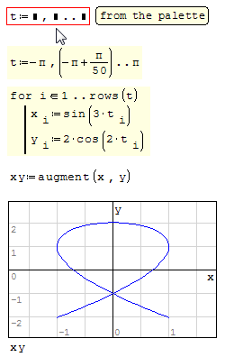

I would like to plot a function using vectors as in the tutorial (page 3) Tutorial
How to make vector like this x:=-pi,-pi+pi/20..pi? Comma i is my decimal sign so i guess i should use as argument separator ";".
When I write x:=-pi and press semicolon (comma i is my decimal sign) nothing happen...
javascript:__doPostBack('forum$ctl03$PostReply','')
#2 Posted: 7/9/2018 5:38:55 AM
You should use the function range(2) or range(3). The same is obtained by choosing it from the Matrices palette.
#3 Posted: 7/9/2018 7:28:26 AM
How to make vector like this x:=-pi,-pi pi/20..pi?
Just like Radovan has explained.
