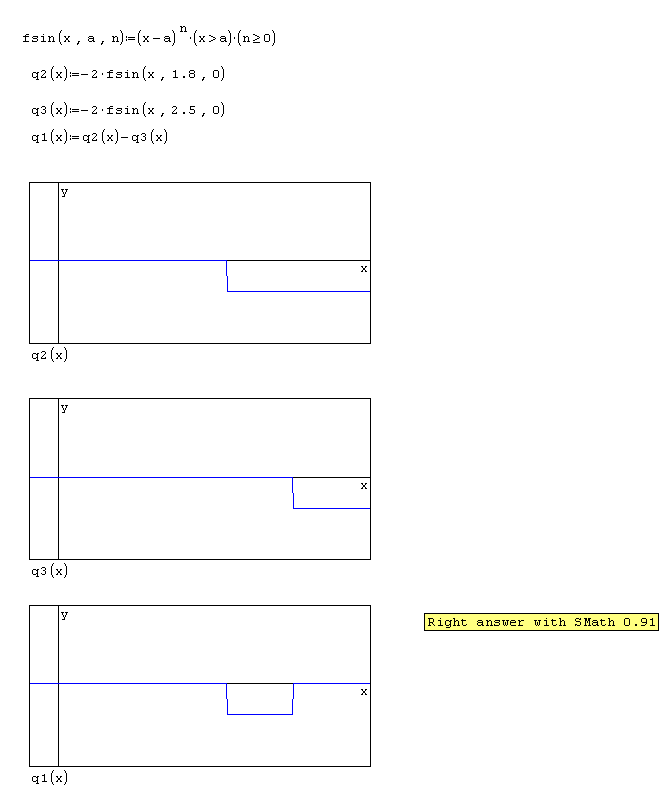

Hi Andrey,

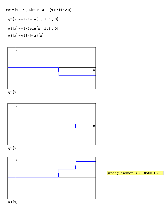

I test the new version (0.93) and found the same problem that version 0.92. This is the result from same file.
Plotting in 0.91:
Plotting in 0.93:

Sorry, but in my post I show that problem persist in 0.93. It is not fixed.

same results of oscampo with Smath 0.93, win7

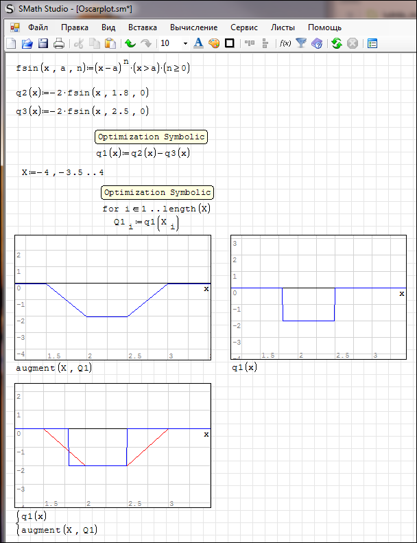

#7 Posted: 3/7/2012 3:53:51 AM
I think I found the problem. It seems it is again regarding Optimization
Look at the first picture please:
The blue line is a function of x, as in the Oscar's example. The red line is plotting two column vectors. I used the larger step just to see the difference. Either way the q1(x) has been calculated wrong.
Here is another picture with Numerical optimization applied on both q1(x) and for loop.
This time q1(x) has been calculated correctly. Unfortunatelly, the function plot is still wrong and I do not know how to change this.
Actually there is a way by using eval()
But another problem appeared. I can not see why the error in the third plot. Separate plot are possible but not the joined plot? Could someone try to reproduce or to explain this, please. Here is the file Oscarplot.sm
