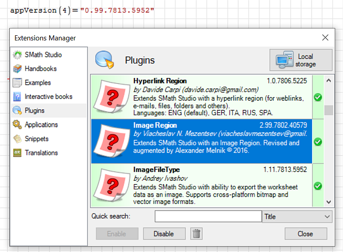

#2 Posted: 5/25/2021 3:55:20 PM
127 likes in 342 posts.
In my case there are no problems, but I have not installed starting from scratch; I updated the previous installation with automatic update.

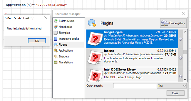

Same bug for me, I updated from previous stable version to 7813 and Image Region plugin auto-update fails.
How do I perform a clean installation from scratch of SMath?
If I uninstall and install back, it cleverly retrieves every plugin that was already installed before the uninstall.
I know I have done a clear installation once previously, some time ago, and I can't remember how to do it again ._.

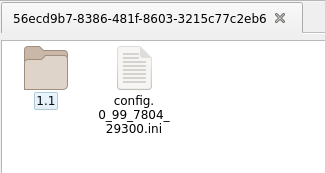

When installing from scratch, issue exist on linux too.
I had my extensions folder copied for backup purposes.
I have found out there are some dissimilarities between new plugins folder and backup.
First of all, imageregion extension folder name is changed.
From 63ddaef8-9a56-4ff6-938e-d590b638bf99 to 56ecd9b7-8386-481f-8603-3215c77c2eb6.
Plugin seems to install on linux but its config file can't open the plugin so it fails to start.
It creates a config file name config.0_99_7813_5952.ini but somehow it fails to load the plugin.
I have copied the config file config.0_99_7804_29300.ini and edited its first line according to new 1.1 folder.
I don't know why but renaming the 7813 file to 7804 didn't make the plugin run. Copying old config and editing it worked.
Hope this information helps to find out the bug.

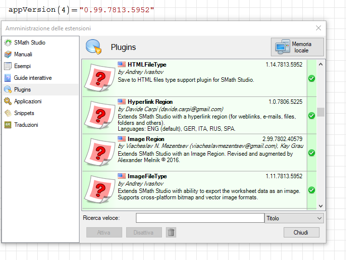

I confirm that the fix is working, I was able to install again Image Region from the plug-in manager. Before the fix, I had an error while updating Smath itself (plugin could not be updated) and subsequently I could not install and activate the Image Region plugin successfully (while everything else on SS 7813 works fine): an error pop-up would inform me that it was not possible to complete the plug-in installation.
Now it completed successfully, thanks
