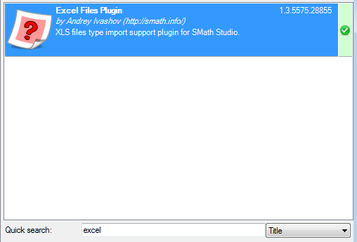

I guess it is "Excel file type" plugin by Andrey:

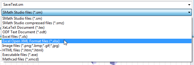

BTW it work for me
