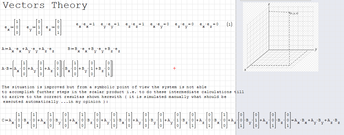

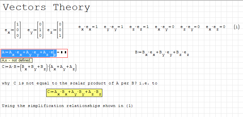

Hi Martin, Davide
I am still working about Vectors and what make me wonder is why using symbolic optimization I do not have a correct result for what concern the dot product (Scalar product) of 2 vectors .
There is something that for sure I am missing ..or I am asking too much to Smath ( I was starting to try the same in WxMaxima , if it works with this tool probably using the Maxima plug-in it should work from within Smath too)
Franco
Franco

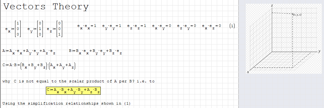

#4 Posted: 10/3/2016 10:47:05 AM
WroteThere is something that for sure I am missing ..or I am askingtoo much to Smath
You are not asking too much to Smath, but you seem not to follow rules
that apply to 1D, 2D, 3D vectors. Those rules are prescribed by convention.
The rules are: Vector * function ... NOT the other way around.
Forum Franco Vector Rules.sm (103.92 KiB) downloaded 1278 time(s).

#7 Posted: 10/4/2016 5:44:55 PM
Jean,
I am able to open your example but I simply do not understand the relationship of you example with the issue I am reporting.
As already stated I don't want with my calculations to come up with a number but I would like to see in Smath that the scalar product ( or dot product ) of 2 vectors is the sum of the products of the components on each axis i.e that what should comes up from the symbolic calculations of the product is what is highlighted in yellow herewith :
I don't know if this request is too much for the internal Symbolic engine.
Moreover despite what is shown in the Davide's e-mail I can't evaluate numerically the expression of vector A but I have the expression in red with the error message A.x is not defined ( even because it would be impossible to evaluate it numerically ..I guess or I don't understand clearly the meaning of the "=" operator ).
I am using Smath Studio 0.98 build 6103.
I am pushed to think that Smath does not recognize that the expression of A is the definition of a vector as well the definition of B; so that when I apply the dot vector operator on these structure doesn't happen anything and are not applied the correct simplification rules ( but this is just my modest opinion about what is happening ).
Franco
Franco

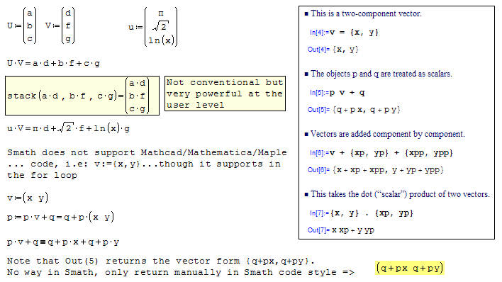

#9 Posted: 10/4/2016 7:30:45 PM
Franco,
No matter what A,B,C will be, from the onset your attempt is wrong.
Why wrong ? You have valued e(x,y,z). So, the next WHATEVER can't
be [A,B,C]*e(x,y,z) but e(x,y,z)*[A,B,C]. That's what the work sheet
previousely attached demonstrates for the 1D, 2D, 3D applications.
I don't understand "projection on axes...". There are 24 ways of
representing a 3D axis sytem. Mathematica and Mathcad don't have
identical system. Smath has no 3D system except the one from
"CreateMesh" or its native 3D plot. The 3 orthogonal directions
result from "monkey business creation".

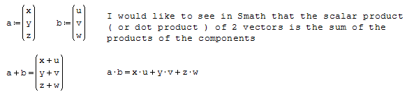

![Forum Wrong Vector [Sum dot].gif](/en-US/files/Download/yYXGGu/Forum-Wrong-Vector-[Sum-dot].gif)

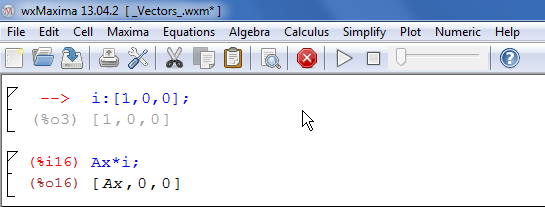

for what concern your 1st point I guess that instead of declaring a variable a similar result can be accomplished using a different operator .
In WxMaxima I see that the multiplication of a scalar by a vector is done using the "*" while the dot product of vectors is through "." ; in Smath there is just one operator for everything and this probably my be an issue.

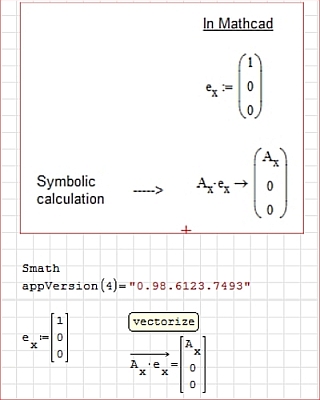

Hello NDTMA,
yes your feedback is helpful , I do not use Mathcad but I see that its symbolic evaluation is correct and leads to a vector and the application of the Vectorize tecnique in Smath is a good approach to address my issue ( but to tell the truth I consider this a good tip more than a proper solution ) , need to study and understand it better, I have never used it extensively.
What make me wonder is what Mathcad uses to do the dot product of 2 vectors whose result is a scalar, it has to be something different from "." I guess ( probably a wrong guess)
Thanks a lot
Franco

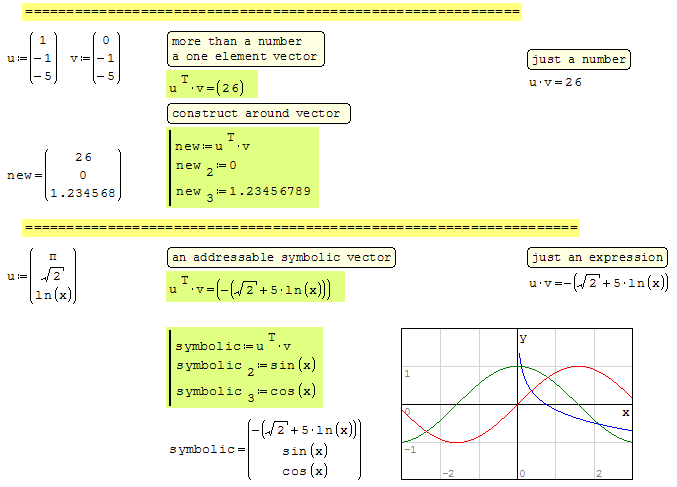

![2016-10-03 10_22_35-SMath Studio Desktop - [vectors.sm].png](/en-US/files/Download/zbVa5E/2016-10-03-10_22_35-SMath-Studio-Desktop---[vectors.sm].png)
