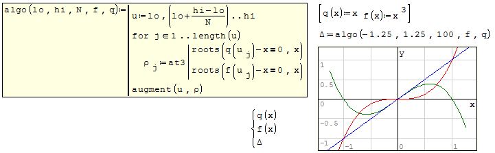

... here is a typical seeded roots scanner.
You can spline for in-situ calculation.
Solve Inverse [Seeded Scanner_roots].sm (16.52 KiB) downloaded 1071 time(s).

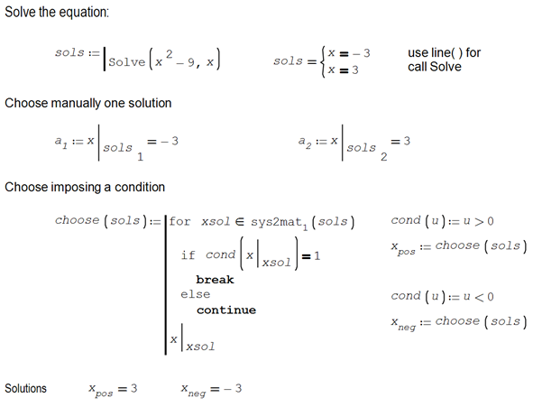

Hi. You can try this approach.
filter maxima solve solution - choose.sm (8.72 KiB) downloaded 1281 time(s).
Thanks! Very interesting use of the at() function, I didn't know it could be used with Boolean also. I not fully understand what the line() does to Solve(), but I tried without and and seen for myself that it will not work without.

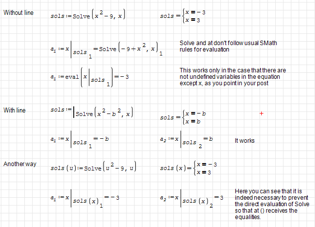

#11 Posted: 10/18/2021 12:06:39 PM
the line is local definition.
sols:=]for the double vertical ▄
back space on the 2nd one
in the active ▄ solve(x^2-9,x)
More down the document is of local definition style.

#13 Posted: 10/18/2021 1:46:19 PM
1,139 likes in 1,805 posts.
... I not fully understand what the line() does to Solve(), but I tried without and and seen for myself that it will not work without.
Hi. line( ) does the same as defining sols (u) = Solve (eq, u)
filter maxima solve solution - line.sm (11.49 KiB) downloaded 1286 time(s).
