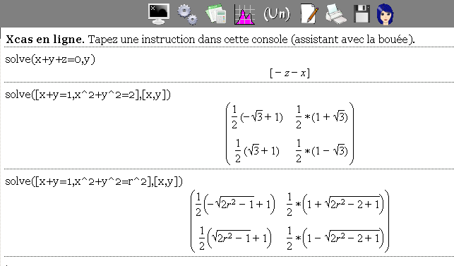

If this is XCAS we are talking about, here is a screenshot from the on-line Xcas:
Xcas
