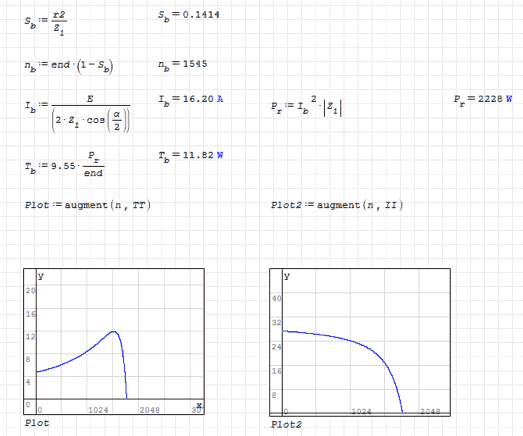

I am trying to to the following:
n:=[1..1200]
s(n):=(1200-n)/1200
I(n):200/(1+2/s(n))
"I get an error divisor matrix must be square"
any suggestions???
Vijay

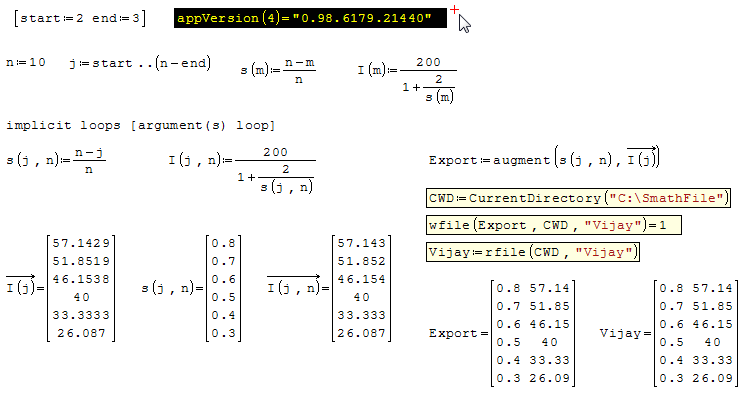

#5 Posted: 3/15/2018 1:29:30 PM
1,361 likes in 2,275 posts.
you divide by a vector. If you want to apply that by element, then use the vectorize operator.
Alternatively, you can use implicit loops.
In any case make sure that you don't divide by zero.
To upload images or files, use the paperclip button ("Insert an existing...." )
matrix2.sm (19.87 KiB) downloaded 1166 time(s).

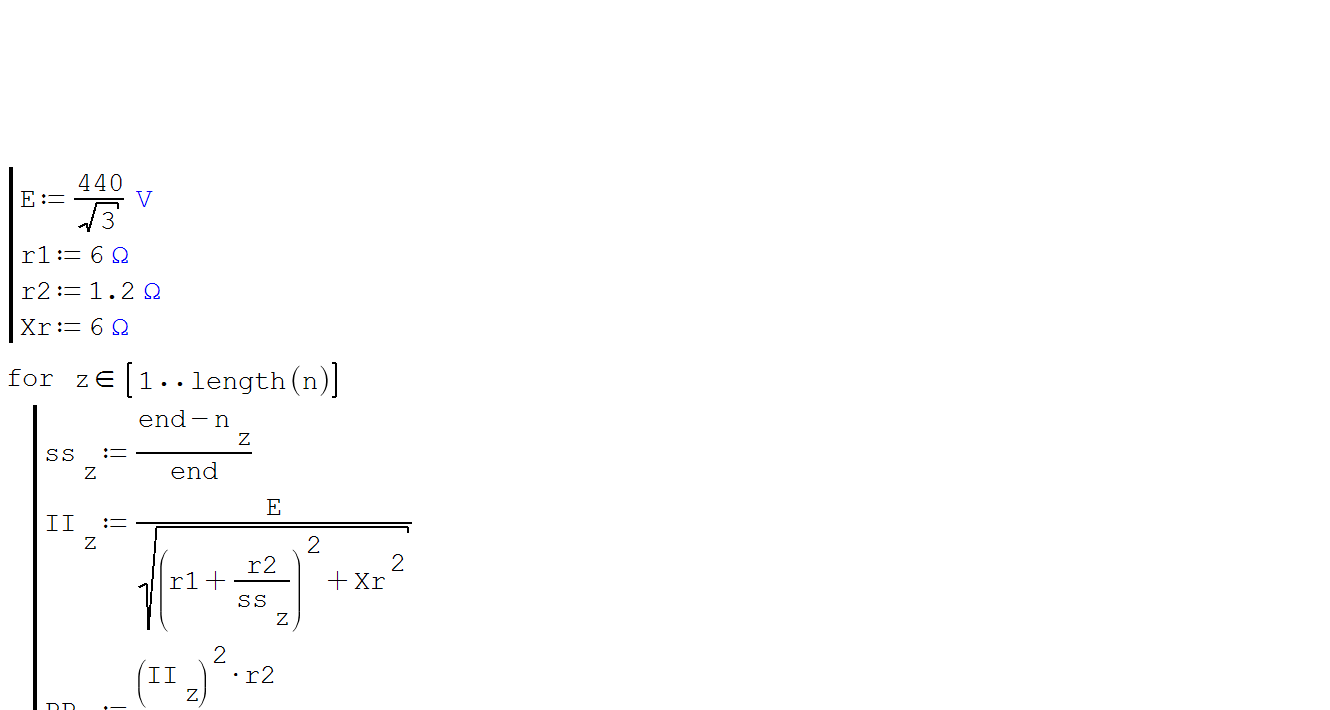

#8 Posted: 3/15/2018 6:34:53 PM
Too many parameters are missing to reproduce
r1, r2, E, x [u in Smath ... back to x in plot]

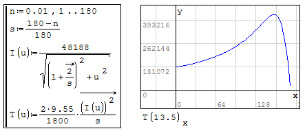

#9 Posted: 3/15/2018 11:21:52 PM
vijaykhatri
vijaykhatri
1 likes in 23 posts.
Thank you for your efforts, that's what I am looking for. I am resending the data with all the information. I have a few questions on your previous post, there is an arrow above 2/s and I(u)^2.What is that function. Also, you have used the value of u = 13.5? Also, when you plot the graph, did you just type T(13.5) to get the graph?
#10 Posted: 3/16/2018 12:18:34 AM
I am re-sending the data with all the information.
1. The arrow is the vectorising operator [same as Mathcad].
2. 'u' is the wild parameter of same nature as r1,r2
3. The system runs over 'n' taken into account wrt the vectorised arguments.
4. Shift@ to get the plot region, type T(13.5) then [ to get the index operator
then type x. The Smath plot argument is 'x'. So, by indexing, it will plot over
the running 'x'. If you want to plot ln(x), just type ln(x) in the plot place holder.
I will try to code your latest information, but busy next three days.

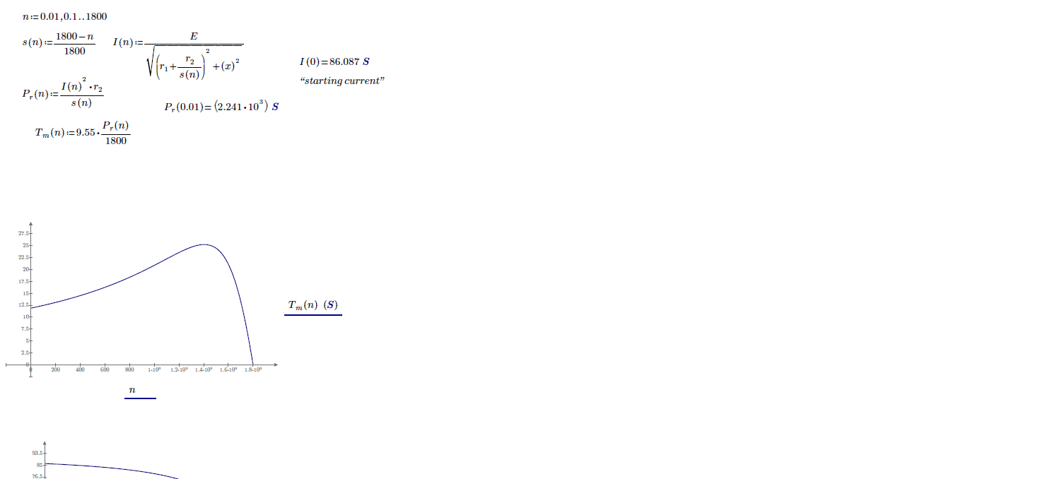

#11 Posted: 3/16/2018 12:55:26 AM
Now, you have another story [a different project].
Vijay(1).sm (26.88 KiB) downloaded 1185 time(s).

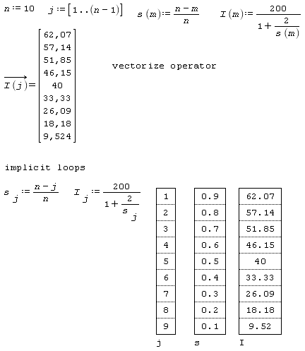

#12 Posted: 3/16/2018 7:46:41 AM
starting from the basics, hope it might help you
example.sm (17.79 KiB) downloaded 1342 time(s).

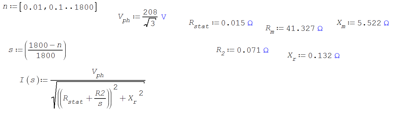

#17 Posted: 3/16/2018 1:46:53 PM
vijaykhatri
vijaykhatri
May I suggest you post this as an example so everyone can
You can mine Smath by visiting "Samples".
Without the circuit, it looks dead.
Attached is another similar file for which I have included the circuit diagram. I am assuming this will be posted in samples in this foroum.File not found.File not found.
#18 Posted: 3/16/2018 7:47:03 PM
CBG
CBG
78 likes in 312 posts.
Something like this?
Vijay_CBG_Jean.sm (13.52 KiB) downloaded 1180 time(s).
#19 Posted: 3/16/2018 8:55:29 PM
Visit => Samples => Motor Analysis [20180316, 19:52]
Drawing was sharpened to the possible limit,
if you have a better one, please offer.
Thank you Carlos, just one question, how did you create the vertical line with multiple entries.
