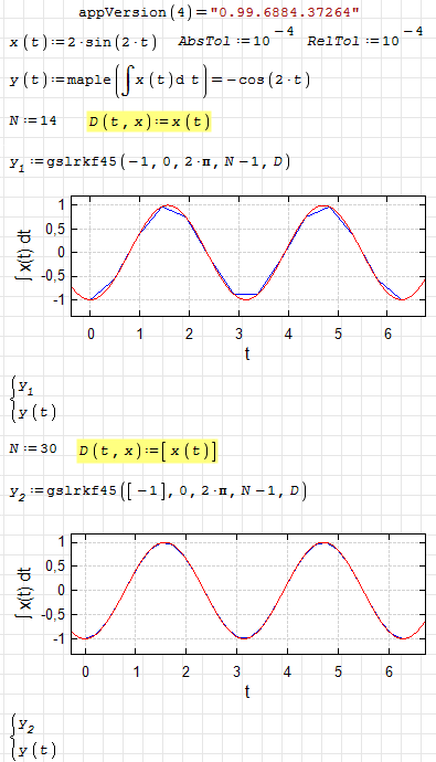

Solvers for Non-Stiff Systems:
gslrk2(init, x1, x2, intvls, D) Explicit embedded Runge-Kutta (2, 3) method.
gslrk4(init, x1, x2, intvls, D) Explicit 4th order (classical) Runge-Kutta. Error estimation is carried out by the step doubling method.
gslrkf45(init, x1, x2, intvls, D) Explicit embedded Runge-Kutta-Fehlberg (4, 5) method.
gslrkck(init, x1, x2, intvls, D) Explicit embedded Runge-Kutta Cash-Karp (4, 5) method.
gslrk8pd(init, x1, x2, intvls, D) Explicit embedded Runge-Kutta Prince-Dormand (8, 9) method.
Arguments:
- init is either a vector of n real initial values, where n is the number of unknowns (or a single scalar initial value, in the case of a single ODE).
- x1 and x2 are real, scalar endpoints of the interval over which the solution to the ODE(s) is evaluated. Initial values in init are the values of the ODE function(s) evaluated at x1.
- intvls is the integer number of discretization intervals used to interpolate the solution function. The number of solution points is the number of intervals + 1.
- D is a vector function of the form D(x,y) specifying the right-hand side of the system

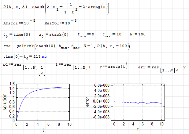

Options:
- AbsTol - absolute tolerance parameter, default value 1E-7.
- RelTol - relative tolerance parameter, default value 1E-4.

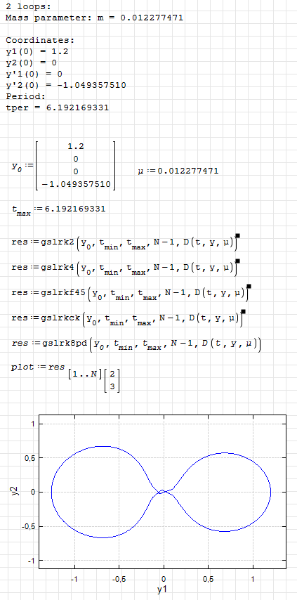

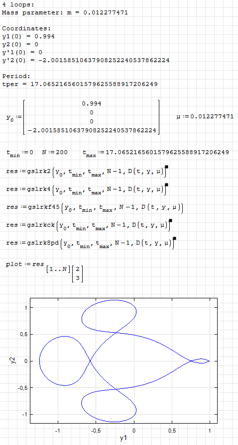

GNU Scientific Library. ODE Solvers. Arenstorf orbit.pdf (99.51 KiB) downloaded 1512 time(s).

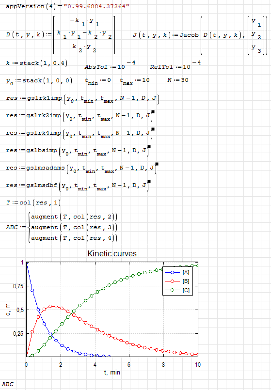

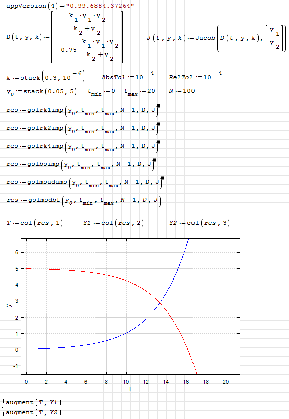

Functions list:
gslbsimp(1) - (cmd) implicit Bulirsch-Stoer method of Bader and Deuflhard.
gslbsimp(3) - (ode,y(x),xmax) implicit Bulirsch-Stoer method of Bader and Deuflhard.
gslbsimp(4) - (ode,y(x),xmax,steps) implicit Bulirsch-Stoer method of Bader and Deuflhard.
gslbsimp(5) - (ics,xmin,xmax,steps,D(x,y)) implicit Bulirsch-Stoer method of Bader and Deuflhard.
gslbsimp(6) - (ics,xmin,xmax,steps,D(x,y),J(x,y)) implicit Bulirsch-Stoer method of Bader and Deuflhard.
gslmsadams(1) - (cmd) variable-coefficient linear multistep Adams method in Nordsieck form.
gslmsadams(3) - (ode,y(x),xmax) variable-coefficient linear multistep Adams method in Nordsieck form.
gslmsadams(4) - (ode,y(x),xmax,steps) variable-coefficient linear multistep Adams method in Nordsieck form.
gslmsadams(5) - (ics,xmin,xmax,steps,D(x,y)) variable-coefficient linear multistep Adams method in Nordsieck form.
gslmsdbf(1) - (cmd) variable-coefficient linear multistep backward differentiation formula (BDF) method in Nordsieck form.
gslmsdbf(3) - (ode,y(x),xmax) variable-coefficient linear multistep backward differentiation formula (BDF) method in Nordsieck form.
gslmsdbf(4) - (ode,y(x),xmax,steps) variable-coefficient linear multistep backward differentiation formula (BDF) method in Nordsieck form.
gslmsdbf(5) - (ics,xmin,xmax,steps,D(x,y)) variable-coefficient linear multistep backward differentiation formula (BDF) method in Nordsieck form.
gslmsdbf(6) - (ics,xmin,xmax,steps,D(x,y),J(x,y)) variable-coefficient linear multistep backward differentiation formula (BDF) method in Nordsieck form.
gslrk1imp(1) - (cmd) implicit Gaussian first order Runge-Kutta (implicit Euler or backward Euler) method.
gslrk1imp(3) - (ode,y(x),xmax) implicit Gaussian first order Runge-Kutta (implicit Euler or backward Euler) method.
gslrk1imp(4) - (ode,y(x),xmax,steps) implicit Gaussian first order Runge-Kutta (implicit Euler or backward Euler) method.
gslrk1imp(5) - (ics,xmin,xmax,steps,D(x,y)) implicit Gaussian first order Runge-Kutta (implicit Euler or backward Euler) method.
gslrk1imp(6) - (ics,xmin,xmax,steps,D(x,y),J(x,y)) implicit Gaussian first order Runge-Kutta (implicit Euler or backward Euler) method.
gslrk2(1) - (cmd) explicit embedded Runge-Kutta (2,3) method.

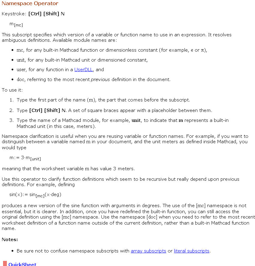

#6 Posted: 8/28/2013 4:50:52 AM
WroteI'll ask Andrey to implement the namespace for functions. This option may be enabled and disabled as the description of the region. In this case, you can specify the function names without the prefix.
I am not sure that I understand correctly, what the namespace for functions concept is meant to be.
Is that something like local aliasing?
Is that a by-region setting?
What is the visualization concept?
I'd expect something like switching on aliasing (and perhaps enabling of the plugin) by a separate statement "with("GLS" ) or with("Matlab" ). This could be
deactivated later in the same sheet by a function without() in a traceable manner.
BTW, how about including a plugin hint in the description string of the functions. I had to search the forum in order to find out what plugin provides the erf() function (Davide, sorry for my leaking memory). Not a big deal for me, but would help to correctly direct user feedback.
#7 Posted: 8/28/2013 5:13:24 AM
WroteI'd expect something like switching on aliasing (and perhaps enabling of the plugin) by a separate statement "with("GLS" ) or with("Matlab" ). This could be
I think it only works for the document in text form. It is unlikely that this method will be useful in our case.
We have one example of namespace support. Not necessarily indicate the selected space, but the user should be able to select it. We can assign a hot key to display the namespace for the selected function.
Davide Carpi 8/28/2013 1:39:00 PM
#8 Posted: 8/28/2013 5:51:42 AM
As I said before, uni is like a man working in a candy store and giving us very good and healthy sweets for free![]()
I see viacheslav and davide more like fabulous dwarves blacksmiths and radovan and martin like mere mortal betatesters, thanks btw :d
#9 Posted: 8/28/2013 8:04:36 AM
Ok, it is a Mathcad concept (I was not aware of that).
The example with m as units and m as variable does not really convince me. By math standards, these items should be distinguished by type face (italic for variables, upright for units or other items that are not supposed to change. SMath has this the other way around, but at least clearly indicates the difference. Thus, the unit name space tag is the apostrophe ' in front of the name.
There is another "namespace" then in SMath, the absolute variables with ~ as tag (which would be fine to represent matrix/vector values).
An option for getting along without new features would be to leave the prefixes in the names and to provide generic names pointing to the most appropriate function from whatever plugin it may come or even to provide wrapper functions like Findroot() to choose from what is available.
The ordinary ("mortal" ) user hardly wants to choose from 20 ode solvers or from 10 nonlinear solvers.

gslrkck simple test.
gslrkck.test1.sm (11.34 KiB) downloaded 1929 time(s).
gslrkck.test1.pdf (48.07 KiB) downloaded 975 time(s).

#15 Posted: 12/12/2018 8:12:57 AM
Updated.
Changes:
- zero point issue fixed;
- added support for the simple D(t,x) definition.
Changes:
