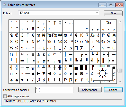

#2 Posted: 12/9/2012 3:00:44 PM
WroteIn astronomy I need to use a symbol that looks like a circle with a dot in the middle as a subscript
see luminosity formulas
http://en.wikipedia.org/wiki/Luminosity
Is there a plugin available with more symbols or can I somehow add more symbols.
cheers
Ivan
Hi IAks,
You don't need a plugin, just the right Unicode character (you can copy and paste the character from one site like Wikipedia, tamasoft.co.jp, alanwood.net or you can add the character holding the U and typing a #CODE# from the numpad)
look the attachments
regards,
w3b5urf3r
solar.sm (1.73 KiB) downloaded 1130 time(s).
frapuano 11/7/2018 4:50:00 AM

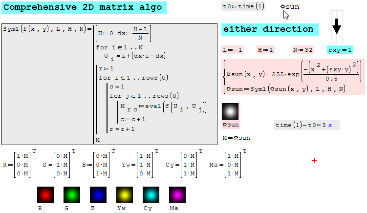

#8 Posted: 11/7/2018 2:59:35 PM
Hi. You can use this for not leave SMath and get the unicode chars that you want:
UNICODE_VAR.sm (2.45 KiB) downloaded 1084 time(s).
Notice that you must to split the unicode char for preventing it substitution with the char itself when copy and paste the expression.

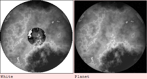

... from 6 years old .
Tentatively we can highlight a specific circular region.
The attached were left unfinished.
Image Planet Luminosity_1.sm (100.57 KiB) downloaded 1067 time(s).
Image Planet c(planet)planet.sm (79.22 KiB) downloaded 1085 time(s).
Image Planet fmap.sm (183.45 KiB) downloaded 1101 time(s).
Image Planet Luminosity.sm (219.14 KiB) downloaded 1030 time(s).
Image Planet Luminosity_2.sm (236.04 KiB) downloaded 1062 time(s).
Image Planet Gamma.sm (315.73 KiB) downloaded 1128 time(s).
