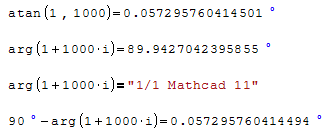

It took me a great deal of effort to figure out why the complex atan function returns the wrong result. I compared it with Mathcad until I realized that it was working partially after I entered 90-atan(a,b)*180/PI. This at least matched the Mathcad result until -90 degrees was reached. Beyond it would require a different combination.
That's not true ... atan(2) from f(x) menu.

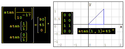

#3 Posted: 3/30/2020 2:02:58 PM
complex atan = atan(2)
Nothing wrong Smath native code atan(2)

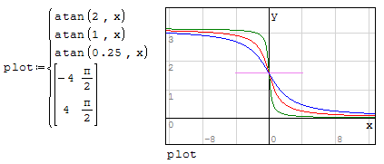

#6 Posted: 3/30/2020 6:22:03 PM

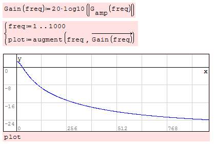

In Electronics Engineering that I am practicing since 1976, Bode Plots are essential. Zedgraph is the only way I found where you can set up the frequency scale logarithmically so that it would present a Bode Plot correctly in Smath Studio.
Based on you checking out the atan2 function and the bad result in Zedgraph I am venturing to say that the issue might be within the Zedgraph plotting engine and not in the Smath Studio software.
So this post of mine should go to someone who is either willing to jump into Zedgraph or create a similarly functioning plotting tool for Smath Studio. I am afraid to say that the standard Smath Studio plotting tool is a bear. It is very difficult to work with not being able to set it up as you wish and it completely lacks the logarithmic scaling functionality that an Electrical/Electronics Engineer would need as presented in my example.

#11 Posted: 3/31/2020 10:14:39 PM
In lot of instances Mathcad 2D plots is more immediate.
Many of my 2D Smath are far superior for publishing.
log-log Bode plots is even more attractive than Mathcad.
I lost patience on that, not being my cup of tea !
No recollection who is the artisan of that one.
Cheers, welcome to Smath Community ... Jean.
2DPlots ZedGraph log-log.sm (100.84 KiB) downloaded 1554 time(s).
