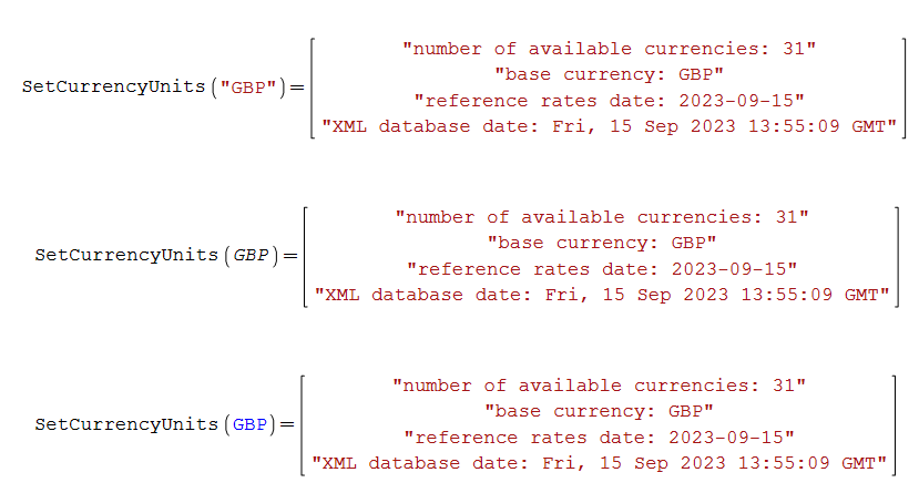

#6 Posted: 9/15/2023 5:48:11 PM
1,441 likes in 2,932 posts.
Hello, The SetCurrencyUnits() function is not posting the current rates.
Fixed both SetCurrencyUnits(1) and SetCurrencyUnits(2), plugin released for latest version of SMath Studio stable.

Many thanks, for your follow back. The date is more recent (was 2015), my date now posts: "reference rates date: 9/22/2022 12:00:00 AM" and "XML database date: 1/1/0001 12:00:00 AM".
I am currently running 1.0.8348.30405. I assume this is the latest stable release?

#8 Posted: 9/18/2023 5:08:57 AM
That's odd. I'll check if I can add some sort of log to investigate the reasons. It might be a firewall problem?
Yes, the plugin is fixed for the latest SMath Studio stable and future versions (>= 1.0.8348).

Ah-ha! My plugin required updating. All works well now.
