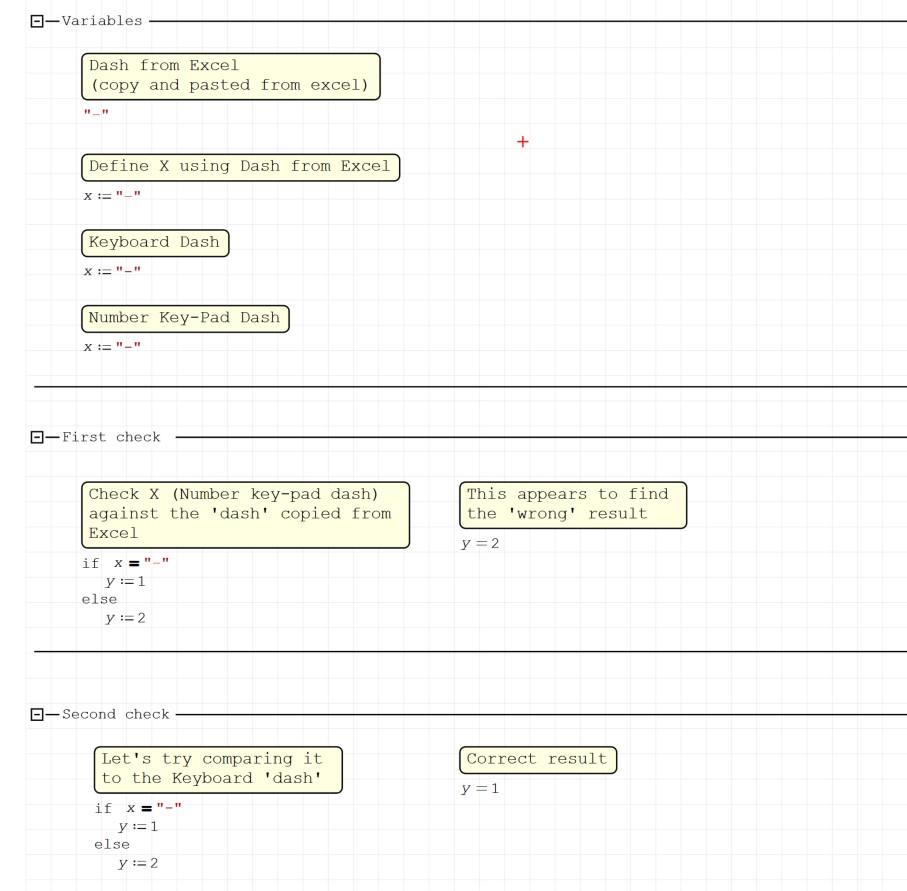

I observed some unexpected behavior when using characters imported from excel. I have a "-" in the cell of an excel sheet which is imported into SMath. When I use this character in an if statement it does not find it to be equivalent to the "-" character in SMath. I'm guessing that it might have something to do with the cell format in excel, but I can't see what sort of information is following this character into SMath. Any idea what SMath is reading the two 'different' dashes "-" as?
Refer to the attached Smath File:

In Excel you used the charakter 2013 (hex), which is the short dash (en-dash): –
If you use the keyboard you will enter the charakter 002D, which is the "hyphen-minus": -
They only look very similar in SMath. But you can notice, that the hyphen-minus is slightly thicker.

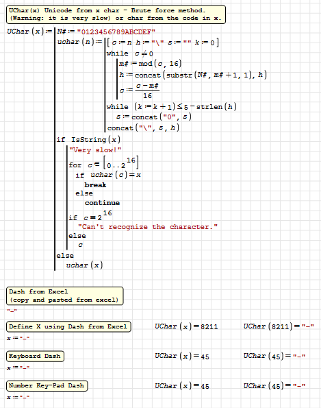

Hi. As MarB says, Excel have it's own things. This function could be useful to try to know what character it is, although it can be very slow if its unicode is large, in addition to also presenting inconveniences if the character is typed or pasted, which I do not understand well.
Steel Worksheet - uchar.sm (16.71 KiB) downloaded 1338 time(s).

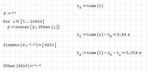

There is another brute force option for character to unicode number - findstr().
The benefit of the approach is that once the search target is built, the search is reasonable fast (0.015 s), you only see it when the calculation runs without problems.

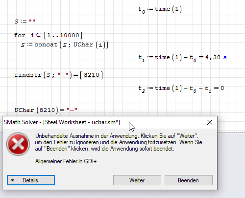

BTW, don't try to display S, this produces a soft crash in both versions.
Also, hovering over the definition of S produces a soft crash, due to the attempt to preview the contents.

![2022-11-15 21_55_01-SMath Solver - [Steel Worksheet - uchar.sm_].png](/en-US/files/Download/P3QgAK/2022-11-15-21_55_01-SMath-Solver---[Steel-Worksheet---uchar.sm_].png)
![2022-11-15 22_17_29-SMath Solver 1.0.8253 - [uchar.sm].png](/en-US/files/Download/FyWyKs/2022-11-15-22_17_29-SMath-Solver-1.0.8253---[uchar.sm].png)

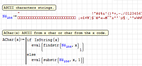

WroteThere is another brute force option for character to unicode number - findstr(). ...
Hi Martin. That's the technique adopted for this function here.
Unfortunately N.256 requires some adjustment as it cannot properly save the characters less than 32.
