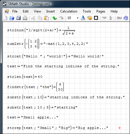

Glad to inform, that today I've added an ablity to use strings inside math expressions!
Here is some new functions:
One "real" example of Arabic to Roman numbers conversion:
This all will be a part of the next release.

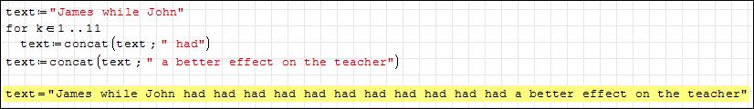

Added ability to get result of the text operations using "=" button (so text could be used in numeric and symbolic calculations now).
Color of the text injections changed (now it is more easy to understand where is text and were is other stuff).
As always, example:
See also: James while John had had had had had had had had had had had a better effect on the teacher
