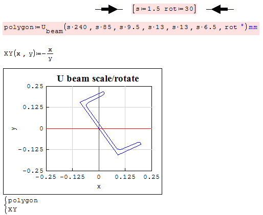

Im gonna explain it graphically
1) on the right you can see stretching of the addon graph
2) on the left you can see fixed XY axis ratio
#23 Posted: 9/26/2018 4:08:27 PM
1,558 likes in 1,868 posts.
Ok, now I see. You need some CAD features for the graph. I wanted to make a separate plug-in for this (based on Opens-CAD). But there is no time for this.
I'll think about what I can do here.

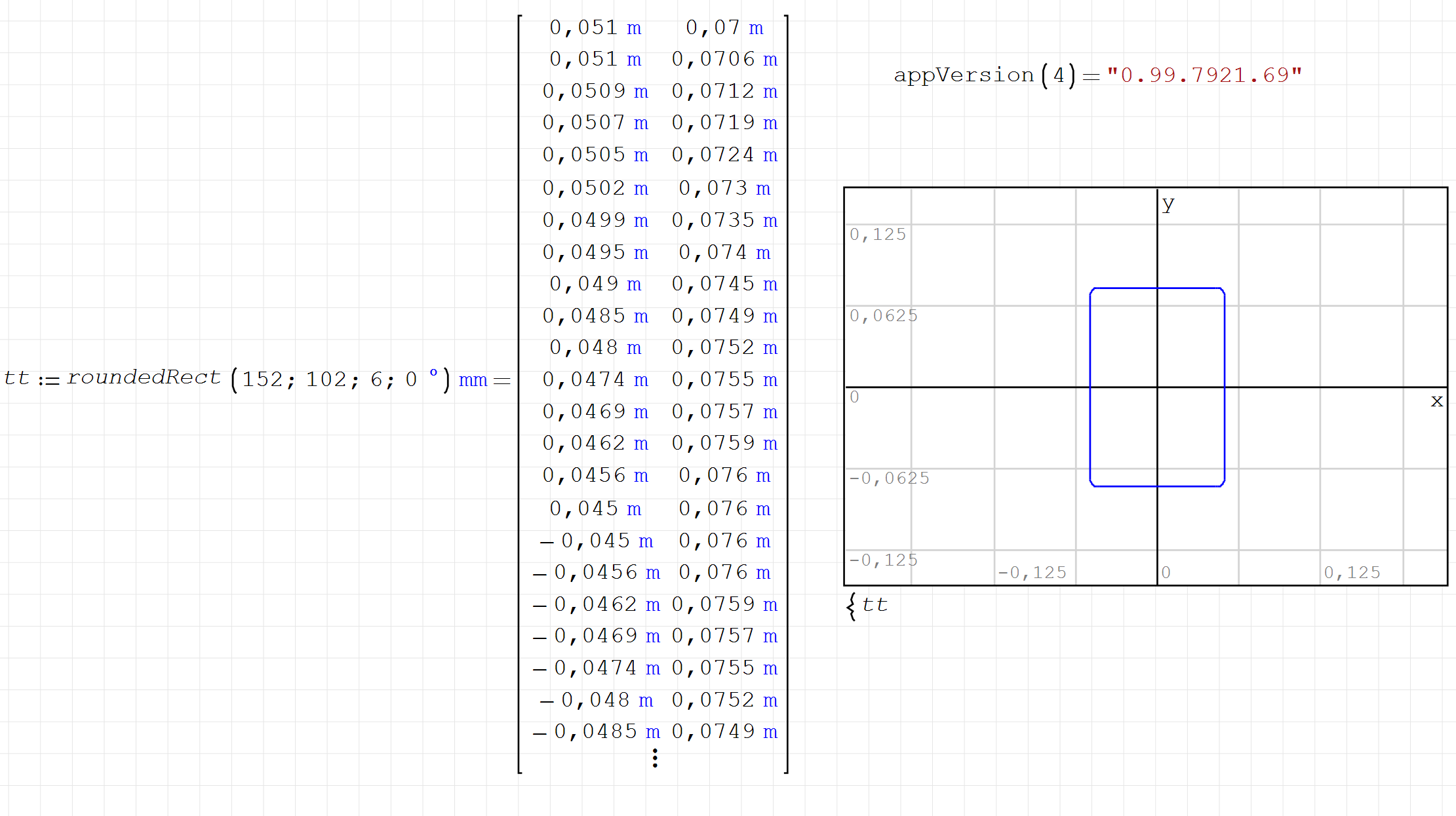

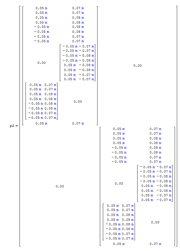

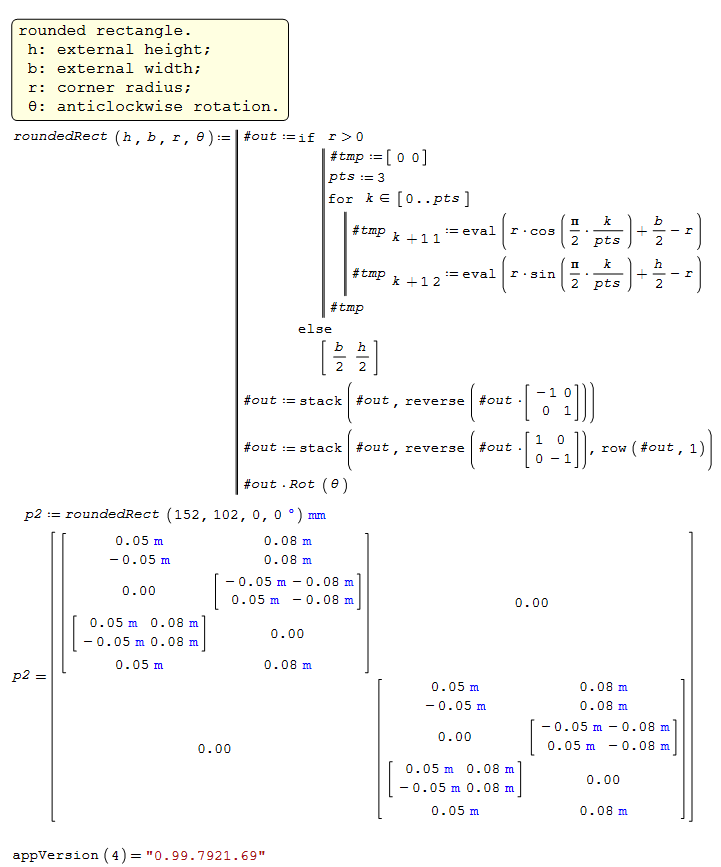

Hi Davide, and thanks for this wonderful sheet.
I found a bug in the sheet, for some reason all the rectangle solid or hollow sections don't work. I am using build 7822.
I tried to test your code and for some reason, the compounded matrix created from your shape functions does not end up being a matrix with "n" rows and "2" columns but rather a matrix in a matrix and I don't know why

Mido0,
try to update, because with the current release it doesn't seem to have problems

Thanks Pompelmo, I updated my Smath and still the problem exists!!
Itried to uninstall all Smath and reinstall it again with the same problem!!

Just change p2:roundedRect(...) optimization from symolic to numeric.
Mo 1/10/2022 7:19:00 PM

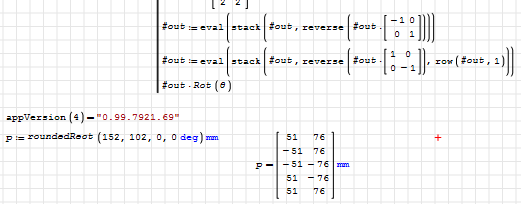

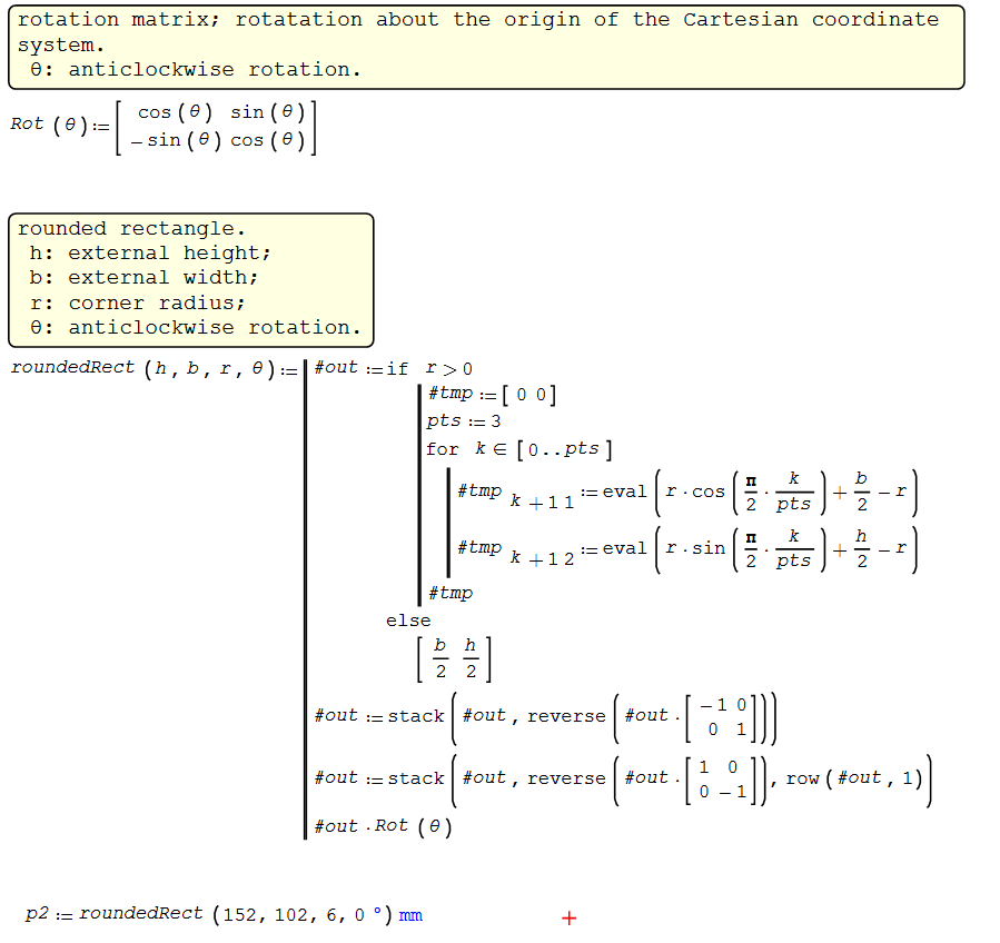

In my personal experience, the stack and agument functions, along with other allies such as reverse and matrix, always manage to cause some kind of issue. The issue also is related about where the evaluation appear, or the function, or something else. The attached shows the issue in an isolated environment.
roundedRect.pdf (124.42 KiB) downloaded 928 time(s).
roundedRect.sm (24.85 KiB) downloaded 1534 time(s).
With those two evals it seems that roundedRect works, for numeric and symbolic evaluations.

THANK YOU, Davide !!!, THANK YOU, Razonar!!!
