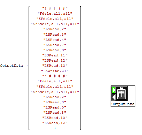

Hellow.
I'm need help.
I'm want to export my Matrix with strings to new txt file.
My result - txt file with quotes near all values.
I need file without quotes.
Any Ideas?

#2 Posted: 3/17/2021 9:43:40 AM
You can try using the plugin "Clipboard Region"
Once installed, go to "insert > Clipboard region" and add one to the canvas, then add the variable in the input placeholder and click on the top arrow to send the data to the clipboard

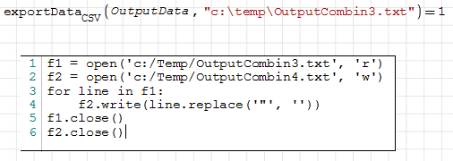

Might just be easier to make a vbscript to drop your output file into that cleans up the data and removes the "". It would be an extra step, but easy to do.
#5 Posted: 3/18/2021 9:05:36 AM
Thank you for ideas.
This my temporary solution.
Now i'm want solve problem with paths... May be...
LoadCombination3.sm (15.74 KiB) downloaded 1114 time(s).
