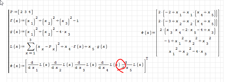

The sum of derivatives has problems. The last line is missing.
Bag.sm (17.58 KiB) downloaded 1446 time(s).

just a typo (+ instead of argument separator after 4th entry)
