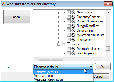

How about using the Document title property from the file header as (possibly multilingual) text in the link regions?
Good idea, I'll explore it.

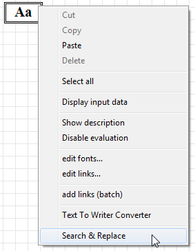

Hello Ioan
In my Extentsions Manager, I found Writer Region 0.3.5880.18795 not 0.3.5800 as you mention here.
0.3.5800 is the minimal requirement (it is just a number easy to remember), any version greater than this is ok.
Also, I'm not able to find Search and Replace Toolbox.
There's not a dedicated toolbox, both the new features are in the context menu of the TextRegionUtilities toolbox.

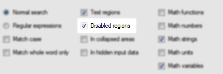

* to have a checkbox to see all findings as selected; this would allow a better global look.
That's a nice idea, I'll see what I can do. DELIVERED
* to search also in the disabled regions (it seems that as now, only the active regions are examined); eventually by checking a box.
This option already exists, doesn't work?

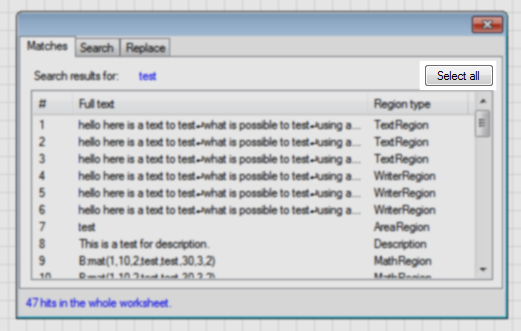

#27 Posted: 2/8/2016 12:58:01 PM
PLUGIN UPDATED
- Search & Replace: FIXED text selection in TextRegion when multiple words are involved;
- Search & Replace: FIXED exception in the "Matches" tab;
Thanks Davide,
Thank you for the feedback Ioan!
1. It's fine. The "Select all" button operate. It selects the whole regions where the search match.
I'm not sure, but I think it woud be preferable to keep the selection of only matched name as for individual name, but to get them all.
The "multiple selection" is available only when a single region is focused, and only for MathRegions (the grey selection you can see using F8).
2. I saw an error by clicking (twice?) on this zone:
Thank you, another "ghost exception". hope it is fixed now.

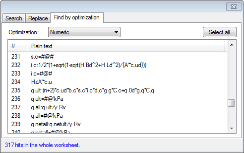

PLUGIN UPDATED
- Search & Replace: added new tab "Find by optimization";

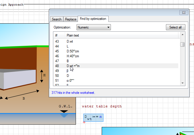

Hello Jean
Not exactly, the "Find by optimization" tool scan the math regions in worksheet looking for the choosen optimization.
If you click on a single result, the worksheet scrolls to that region and select it
2016-02-12 09_11_55-SMath Studio Desktop - [Bearing Capacity_2013.00.01.sm_].png

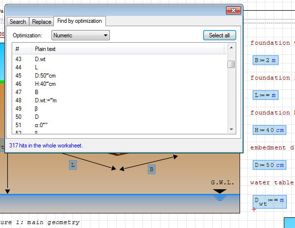

If you click on the "select all" button, all the found regions are selected
2016-02-12 09_13_44-SMath Studio Desktop - [Bearing Capacity_2013.00.01.sm_].png
Any further action on the optimization can be done on the canvas (right click > optimization)
Obviously you don't need this if you want a worksheet with an omogenous optimization (CTRL+A -> context menu on a math region -> optimization), however a sanity check is always good practice.
Done. Metadata title or description can be used as text of the hyperlinks (on *.sm files, if available, otherwise the filename is used)

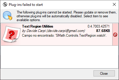

I seem not to be able to install the TextRegionUtilities plug-in with the latest version of Smath Studio. I get the following message when I try to install the plug-in:
Field not found: 'Smath.Controls.TextRegion.watch'.
appVersion(4)="0.99.7045.23606"
Windows 7
Thanks in advance for any help.
#38 Posted: 4/24/2019 10:23:31 AM
Farja
Farja
1 likes in 7 posts.
With the last version of Smath (0.99.7053.26276), the error is still present.
#39 Posted: 4/25/2019 6:36:59 AM
Thank you, confirmed. That property in the API is no more available, I'll check what can be done.
