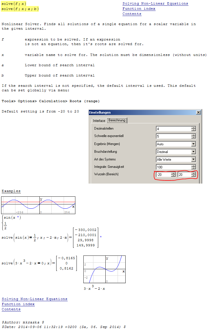

SMath Forum SMath Studio Bugs & Problems Ошибка решения 1 Pages (3 items) Ошибка решения - Smath Studio не решает простое уравнение - Messages Go to last post #1 Posted: 4/6/2018 10:06:20 AM Вадим 0 likes in 2 posts. Group: User "solve(m/7-3;m)" не может решить, а "solve(m/6-3;m)" решает. Почему? #2 Posted: 4/6/2018 10:24:06 AM Martin Kraska 1,332 likes in 2,241 posts. Group: Moderator solve.sm (23.35 KiB) downloaded 754 time(s). Technische Mechanik mit SMath Studio: https://link.springer.com/book/10.1007/978-3-658-50592-9 1 users liked this postВадим 4/6/2018 11:46:00 AM #3 Posted: 4/6/2018 11:47:50 AM Вадим 0 likes in 2 posts. Group: User Thank you very much! 1 Pages (3 items) New Posts No New Posts
