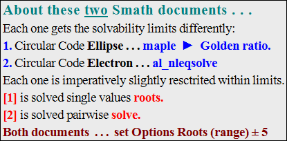

SMath Forum SMath Studio Samples SOLVE Contour Primer 1 Pages (1 items) SOLVE Contour Primer - SOLVE Contour Primer - Messages Go to last post #1 Posted: 5/4/2021 10:37:39 AM Jean Giraud 983 likes in 6,866 posts. Group: User More is in the brew, solving for iso-curve.Not doing as exemplified would complain NO real roots.These two examples are simple lecture guide line, ToolBox.Contour SOLVE Circular Code Ellipse.sm (54.55 KiB) downloaded 1329 time(s).Contour SOLVE Circular Code Electron.sm (52.7 KiB) downloaded 1367 time(s). 1 Pages (1 items) New Posts No New Posts
