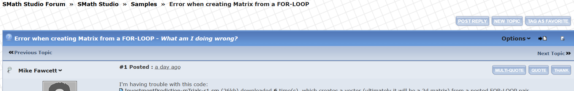

I'm having trouble with this code:
InvestmentPrediction-mTrials-r1.sm (25.82 KiB) downloaded 1732 time(s). which creates a vector (ultimately it will be a 2d matrix) from a nested FOR-LOOP pair.
It keeps returning an error (Result is above the max allowed positive number) after about 5 runs through the FOR_LOOP. I have verified that the result is not a large number -- it's less that 1,000 as you can see for "Val" near the bottom of the first page. I'm left to conclude that the maximum number has something to do with the index of the vector "Val". But I can't find anything in the literature indicating that there is some limit to this index. After weeks of reading and trying variations I've just about run out of ideas. Can you help me understand what I'm doing wrong?

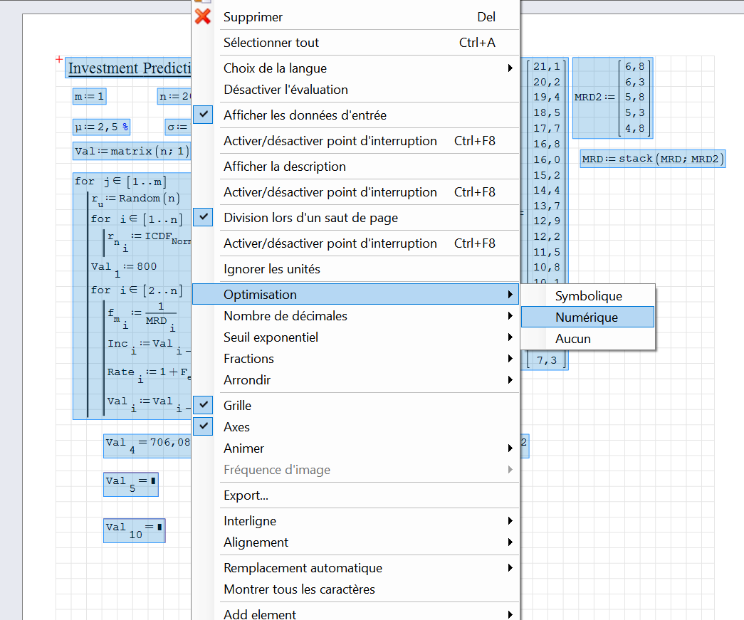

#2 Posted: 2/14/2025 2:52:37 PM
Hi Mike,
Try to put "numerical optimisation" over your formulas.
Ioan
Ioan

4. As about “optimization mode”, you cans specify your option for the whole program, by selecting (Ctrl+ A) all the content and then right click the mouse and precise yous option, as here:
Hope being helpfully,
Ioan
Ioan
