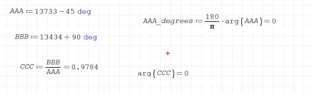

WroteThankyou, but, sorry... I must be doing something wrong here?
I can't understand why I'm getting zero values, perhaps I'm entering the angles incorrectly?
Indeed, you do.
You are adding radians to degrees not real and imaginary components.
you would need to make a function to convert polar representation to cartesian representation and back.
#5 Posted: 7/6/2023 11:23:54 PM
Thanks Lupus. I think in which case I'll use Octave instead. It's not quite as elegant looking as SMath and neat for copying into reports, but simpler for entering complex numbers in polar form, etc.
