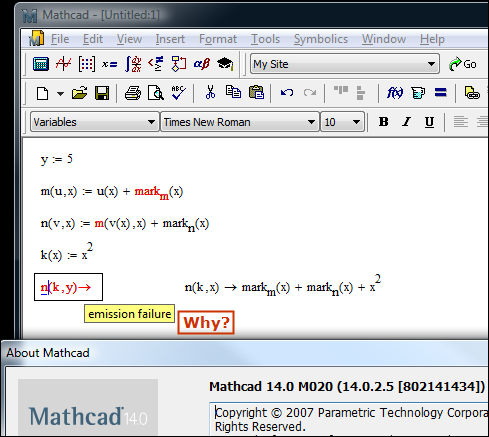

Strange behavior of Mathcad found:
Same situation in SMath Studio:
Any idea why Mathcad can't evaluate this properly?
P.S.: This is a test file I've made to check SMath Studio.

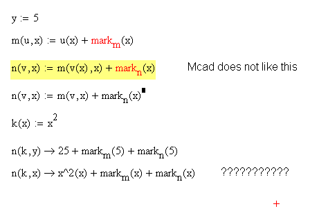

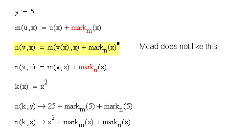

#5 Posted: 6/28/2010 5:59:08 AM
Hello Andrey,
As far as I know, Mathcad does not use something like f(a,y):=b(a(x),x)+x in generall. Function arguments are only names (variale or function names). Function argument in the user defined function could not be "a(x)" - it must be just "a". Although, there are few exceptions. I do not use Mcad 14 but here is the image from an older Mcad version. However, It should be noted that there are different symbolic engines applied. Mcad 14 uses MuPad and older versions use Maple.
Please look at this image. It seems Ok.
But, if you change "v" into "v(x)" the results here is quite strange and sometimes unpredictible. I suppose this is because the Maple engine is involved here, and the problematic Mathcad use of Maple.
On the other hand, it seems that Mcad 14 can cope with it and I suppose that the problem is in y which is a constant not an undefined (symbolic) variable.
On the other hand SMath must work with the expression like v() pointing that this is a function with arguments (I hope I am right).
Regarding that those are just starting efforts, SMath example seems to me more understandable.
#6 Posted: 6/28/2010 6:44:19 AM
2,343 likes in 4,042 posts.
Hello.
Ah, yes. You're right, it is because I call m(v(x),x)... it should be m(v,x). Thank you!
Regards.
