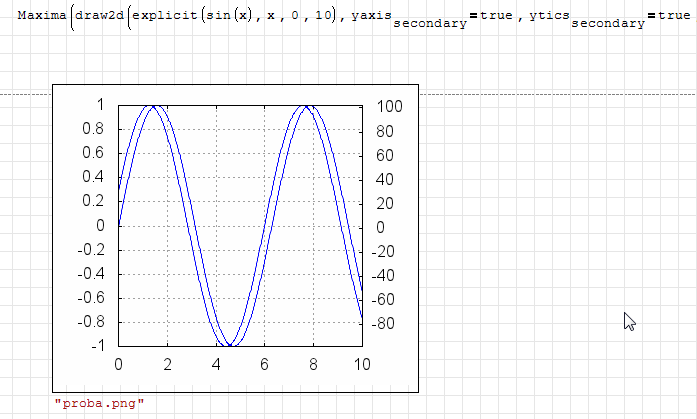

#26 Posted: 12/28/2013 2:42:48 AM
Resizing the images works for images created with the standard gnuplot interface of Maxima, images generated with the draw package still cannot be scaled (did not yet find the right settings).
Ah yes, you are right. Did not pay attention, sorry.

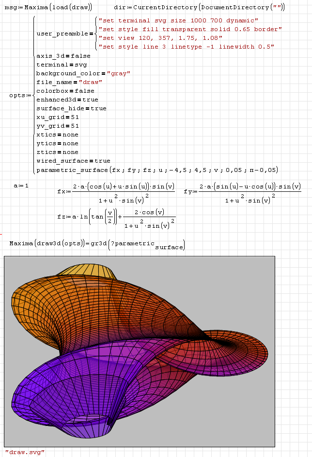

Here are some examples with draw package
Martin Kraska 1/2/2014 10:27:00 PM
#27 Posted: 1/2/2014 10:28:44 PM
1,361 likes in 2,275 posts.
from the gnuplot examples page
#28 Posted: 1/2/2014 10:30:29 PM
From the gnuplot examples page
EDIT: file corrected
Example Maxima Gnuplot transparent solids.sm (10.42 KiB) downloaded 1368 time(s).
Radovan Omorjan 1/3/2014 2:43:00 AM, Вячеслав Мезенцев 1/3/2014 12:31:00 PM
#29 Posted: 1/3/2014 2:44:22 AM
Thank you Martin,
I did not have a success for this example. Here is the log file. I suppose the problem is in the international settings (coma, semicolon etc.)
Maxima.zip (1.19 KiB) downloaded 448 time(s).

#30 Posted: 1/3/2014 5:13:08 AM
I uploaded the wrong version of the file, corrected now. Lists as function arguments seem to have some complexity limit. Inspection of the log file shows that the translator re-uses the strings from the preamble list in the right hand sides of other options, where expressions are expected, not strings. I don't know if there is a quick fix.
In the meantime, we either have to limit the complexity or to define Maxima variables.
You can assign the previous expression to a variable l by Maxima("$l:%$" )
Radovan Omorjan 1/3/2014 6:32:00 AM
#31 Posted: 1/3/2014 6:35:48 AM
Yes it is Ok now. Thank you

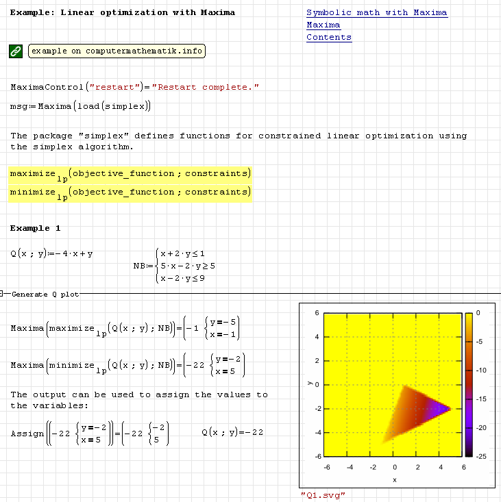

Example for linear programming and plotting

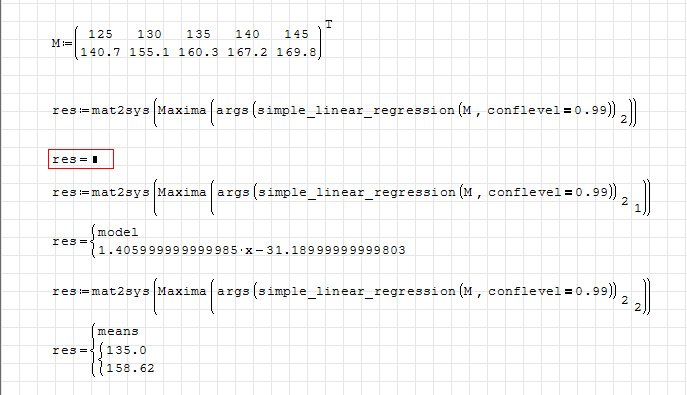

#34 Posted: 1/3/2014 1:04:28 PM
There seems to be a problem with display of functions with list arguments. In the given case, you can avoid the function in the output by wrapping it in args(), which returns a list of the function arguments.
The outer mat2sys is just for cosmetic reason. I just prefer that type of results being left justified.
Make sure to set optimization None in the function call and in results display to get float results. Opt numeric won't work due to the texts being bare variable names.
It seems that the functions are capable of handling matrices.

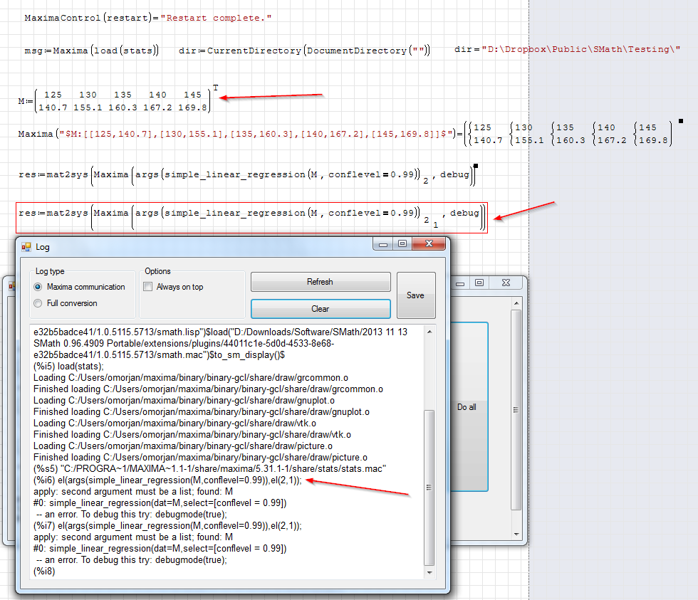

#35 Posted: 1/3/2014 1:57:02 PM
Unfortunately, it does not work for me.
I can not use matrices here, therefore I defined it in Maxima with Maxima( "$ $" ). If I use a matrix like you did with matrix M, the error message in the debug window appeared
apply: second argument must be a list; found: M
#0: simple_linear_regression(dat=M,select=[conflevel = 0.99])
-- an error. To debug this try: debugmode(true);
(%i7) "
Moreover, when I use the same command as you did, no result - stack empty again, although still look that the result is here - see the log file please.
Maxima.zip (1.19 KiB) downloaded 429 time(s).

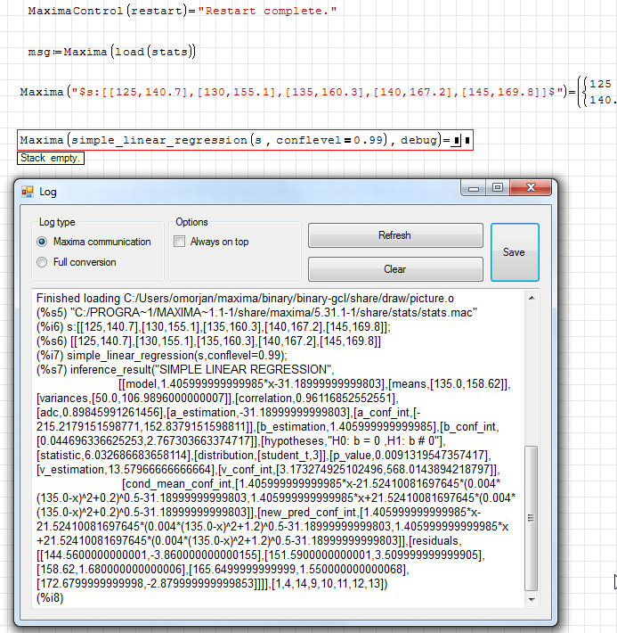

#37 Posted: 1/3/2014 5:42:58 PM
I use the same Maxima version as you do 5.31.1-1. I am really puzzled that whatever works for you in this example, it does not work for me. I just tried and again here are the two pictures with matrices M defined in two ways and their respective logs - with errors. I also noted that matrix M is referred as second argument? Have no idea what that might be. I alo tried to change the arg/dec into coma and semicolon - no sucess.
If there is anything else I could try regarding this - just let me know. Otherwise, we can just wait for Kay

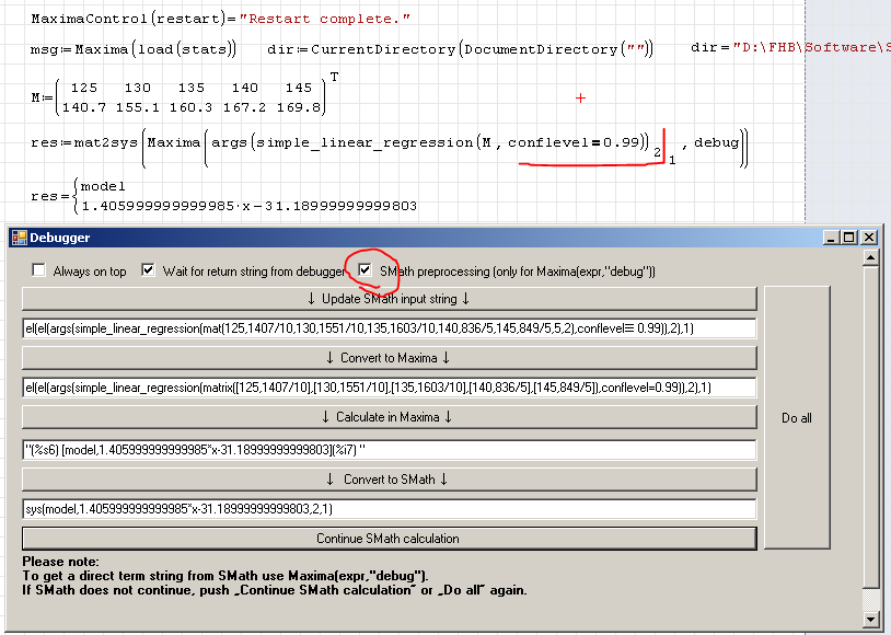

#38 Posted: 1/3/2014 7:00:21 PM
I think there are two problems:
1. If in the debugger, you have to set the preprocessing flag. Otherwise M is not replaced by it's symbolic contents. The dialog is obscured by the log but I would bet a pivo that you did not set the flag ;-)
2. You applied the second el() function to the index 2, not to the complete expression. You want the first list from the result structure. I admit, that this was not obvious from the screenshot.
Removing the debug flag from the Maxima call and correcting the el function should do the job.
#39 Posted: 1/3/2014 7:11:51 PM

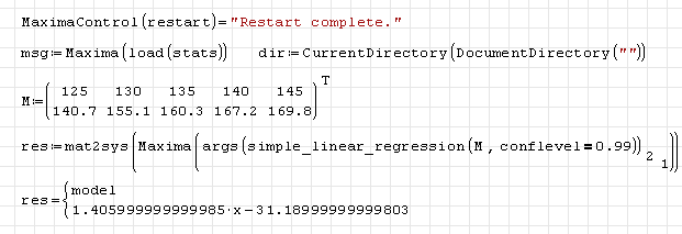

#40 Posted: 1/4/2014 4:34:50 AM
You definetelly won a pivo (more than one actually ).
You are right again, my mistake sorry. Here is the screenshot. If I understood you well, the complete calling of the entire system here is problematic - maybe a bug (sometimes it crashed for me as well) but it can be done by calling one by one - like in the picture.
