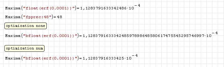

By the way, I was playing with the special functions from Maxima. It seems to work pretty well, except I do not know how to deal with small numbers - look at the picture please.
Maxima_spec_functions.sm (10.8 KiB) downloaded 1595 time(s).
Martin Kraska 9/25/2013 12:19:00 PM
#3 Posted: 9/25/2013 2:25:47 AM
E must be replaced by *10^ before sending the answer to the canvas (inside the plugin, obviously)

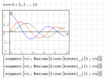

Maxima functions normally can handle vector or matrix arguments (applied by element). Thus plotting should be possible without loops.
There seems to be an expression size restriction for the Maxima call. If the increment in vx in the bessel plotting example is reduced, than the evaluation process seems to hang and needs to be stopped.
Fixed, plugin updated. For other changes see Update description sheet

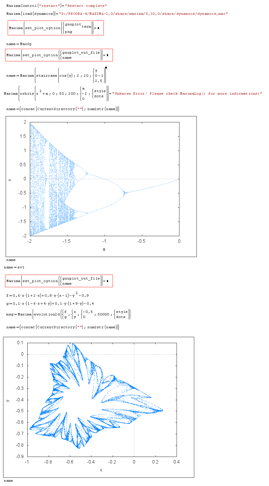

Here is a preview, how plotting can work with the Maxima plugin.
This is actually done using the current public state of the plugin, but cannot be recommended yet for serious work. Setting the plot options is painful (because of the many translation errors it causes) and functionality is very limited therefore. Actually, it is gnuplot doing the job in the background.
Limitations:
- you cannot specify output names with extensions or path specifications (currently no way to convey . or \ in strings to Maxima)
- therefore no way to use svg output, as image region refuses to display svg files without extension (complains about insufficient memory).
- we have problems with list translation, thus parameter handling for plot functions is unstable. Perhaps we need to really parse the expression structure in order to get this right (currently, translation is based on a set of regular expressions).
Edit: the plot files are written to the install directory of SMath.
plotting.sm (22.71 KiB) downloaded 1601 time(s).
Radovan Omorjan 10/17/2013 1:05:00 AM, IVR 10/17/2013 3:54:00 AM
#10 Posted: 10/18/2013 3:47:08 PM
1,361 likes in 2,275 posts.
Some more examples for plots with Maxima and Gnuplot.
Limitations:
- still no way to send strings to maxima, thus no path names, no file name extensions and no options with space characters such as "png size 300 200"
- any command or option must not have strings in it, however, most options may be written as plain variable names.
- different plots need different filenames, it can work with one name for all plots of a sheet but that is not reliable.
- Calls to set_plot_options() fail to display the result in SMath but do their job on the Maxima side.
- EDIT: Again, all this works only, if your current directory is the SMath install directory.
The good news is that so far all plots from the maxima handbook which I've tried did actually work. Also, the format for options spec is quite readable.
plotting.sm (18.84 KiB) downloaded 1532 time(s).
Radovan Omorjan 10/18/2013 4:06:00 PM

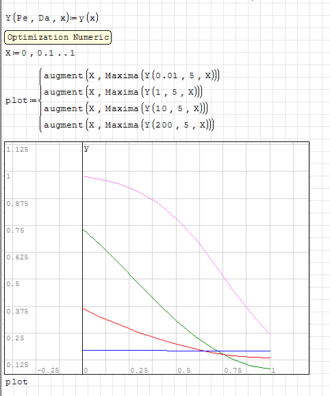

I was playing with ODE.2 (nice job Martin ) and bumped into this difference about numeric and symbolic optimization, again.
I could not see the source of this difference - only in one point, I think (look at the green line please). Have I missed something?
Martin Kraska 10/31/2013 4:19:00 PM
#13 Posted: 10/31/2013 4:26:57 PM
Radovan, thanks for highlighting the problem. The source is in the different handling of expressions of type a^b^c in Maxima and SMath. The fix is much like with the a^-b problem. We include it in the next update of the plugin.

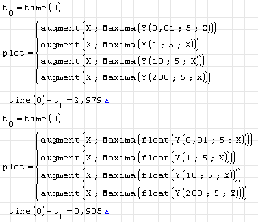

EDIT: you can save computation/translation time by doing the numeric evaluation on Maxima side

... bumped into this difference about numeric and symbolic optimization, again.
Fixed, Plugin updated.

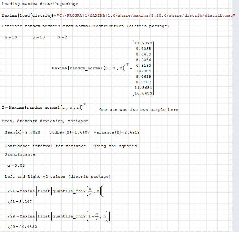

Here is an example of using distrib package in Maxima. One can also use Statistical Tools plugin, but there are some important quantile functions missing there.
I also used Function's Extension plugin.
By the way, I also tried descriptive and stats packages, but they can not be loaded (draw package is problematic here). I do not know what is the problem here. Just accepted that some of the packages, like the mentioned ones, can not be used at this stage of Maxima plugin development. Did not want to bother to much

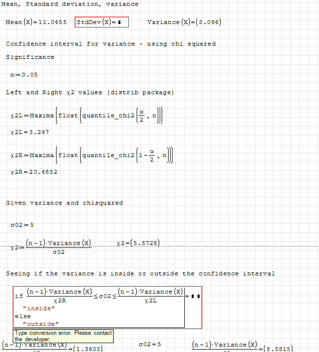

Here what happened on my x64-Win7 laptop and Martin's unofficial build. Find two test files (distrib-Maxima-1.sm and ODE.2-Plugflow-2.sm).
If I open the first one (distrib-Maxima-1.sm) and do the recalculation few times, sometimes it just fail (see the second picture). When I open additionally ODE.2-Plugflow-2.sm and recalculate distrib-Maxima-1.sm, again some unexpected errors appear (see the third picture).
If someone is wiling, try to reproduce please.
Martin Kraska 11/25/2013 1:04:00 PM
#18 Posted: 11/25/2013 1:03:53 PM
Hi Radovan, thanks for your examples on statistics with Maxima.
I can reproduce the reported problem.
Your distrib sheet relies on Maxima not taking over the internal functions, because the sum() function works differently in Maxima and thus corrupts most programs using the sum function (just like StdDev()).
As all sheets of a given SMath instance share the same Maxima session and plugin settings, the takeover/surrender status is global for all open sheets. In ODE.2... you explicitly ask for takeover, thus after doing that, distrib...sm won't work any more.
Thus, add MaximaControl("surrender" ) to your distrib sheet, then the problem is solved.
