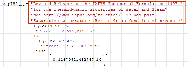

I've investigated the way how Mathcad users documenting their documents. And I see that many SMath Studio users also use the same approach as shown below:
The only possible reason is that Mathcad developers didn't implement some standard way how to create descriptions for the definitions. So, I'm thinking now to do something like this:

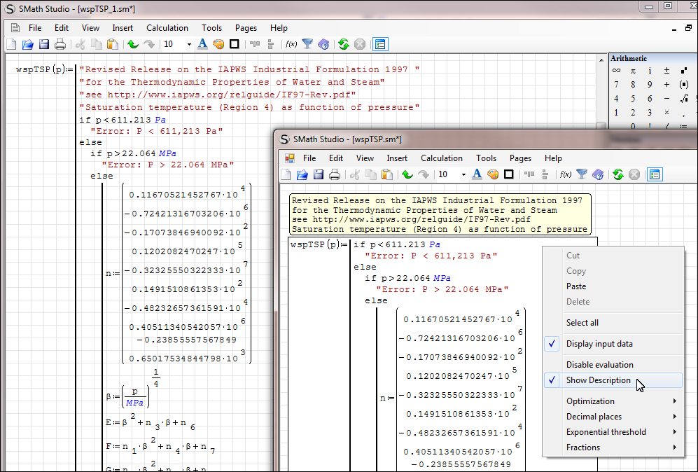

This will also make it possible to use that descriptions in Dynamic Assistance tool:
I'm just started to implement it, so any suggestions or idea corrections will be very welcome!

#2 Posted: 2/26/2012 2:00:39 PM
Hello Andrey,
These function descriptions are in the spirit of SMath. I suppose that there must be some limitation in the description length/hight. If it would be to big, the large amount of worksheet might be covered with the description text.
#3 Posted: 2/26/2012 3:42:20 PM
1,443 likes in 2,935 posts.
great idea
I think the description could be organized to accommodate different fields (i.e. a general description, an input arguments description and an output argument description, or other data, like the revision number...)
