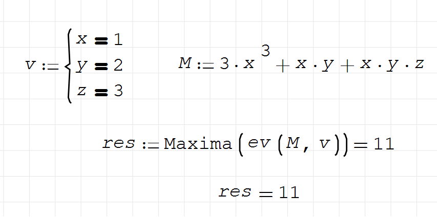

Dear all:
I am new to Smath Studio, great software!
Even I am new to its usage, I am trying quite complicated calculations I guess.
I am putting the following lines:
As you can see, I am using Maxima plugin and the Maxima function ev() to substitute values in the symbolic variable. I have some specific questions:
1.) Is there an alternative way to do this kind of calculations without using the Maxima plugin?
2.) v is a system of values, each value is an equality, is there an automatic way to generate a system of values?
Thank to all the people that could help.

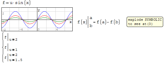

I can't open your image. From what you describe, you might want to use the substitution function at() from Custom Functions plugin.
at.sm (22.23 KiB) downloaded 1300 time(s).

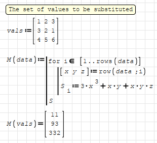

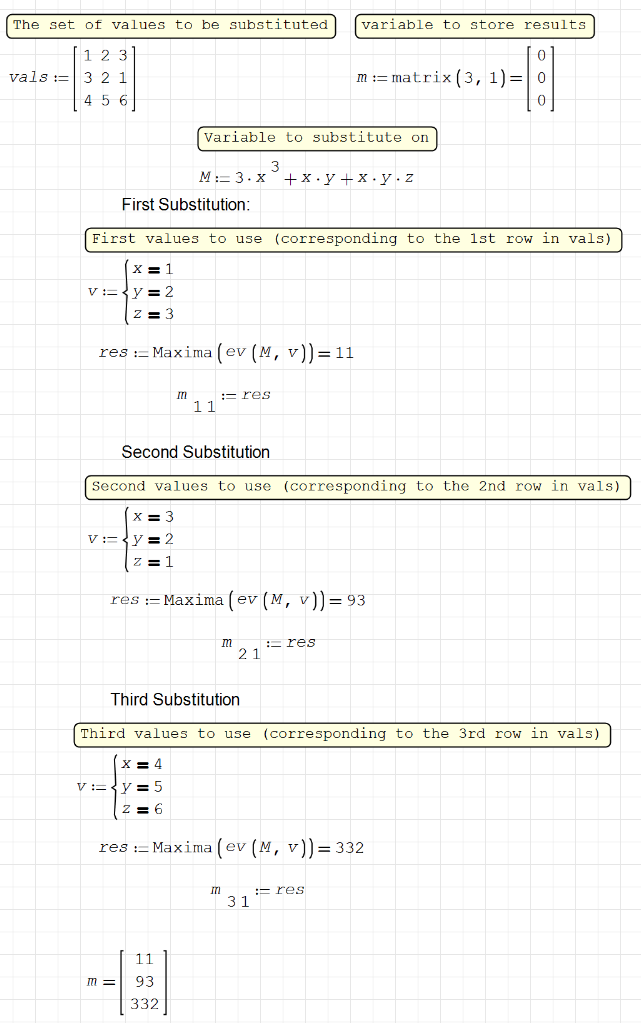

What I want is to iterate over a set o values to substitute in a variable a store the results in a variable, something like this:
Is there a way to do this substitutions in an iterative way?.
I mean: using a set of programming lines?
In this worksheet I copied and pasted the lines to perform the iterations, but in a general problem solving it is desirable to iterate automatically.

Here is the Worksheet:
Worksheet1.sm (10.95 KiB) downloaded 1261 time(s).

Thank you Martin Kraska, at works fine and is what I needed.
It seems that to iterate I have to declare the sys vector by myself, isn't it?
Thanks a lot!

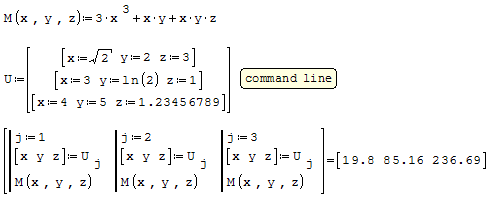

An iterative process is a solving process.
As you say, you just want to plug something from command line.
#9 Posted: 4/12/2022 11:45:16 PM
Mario Acevedo
Mario Acevedo
0 likes in 11 posts.
wow!, this is what I was looking for!!!, THANK YOU very much Jean Giraud!

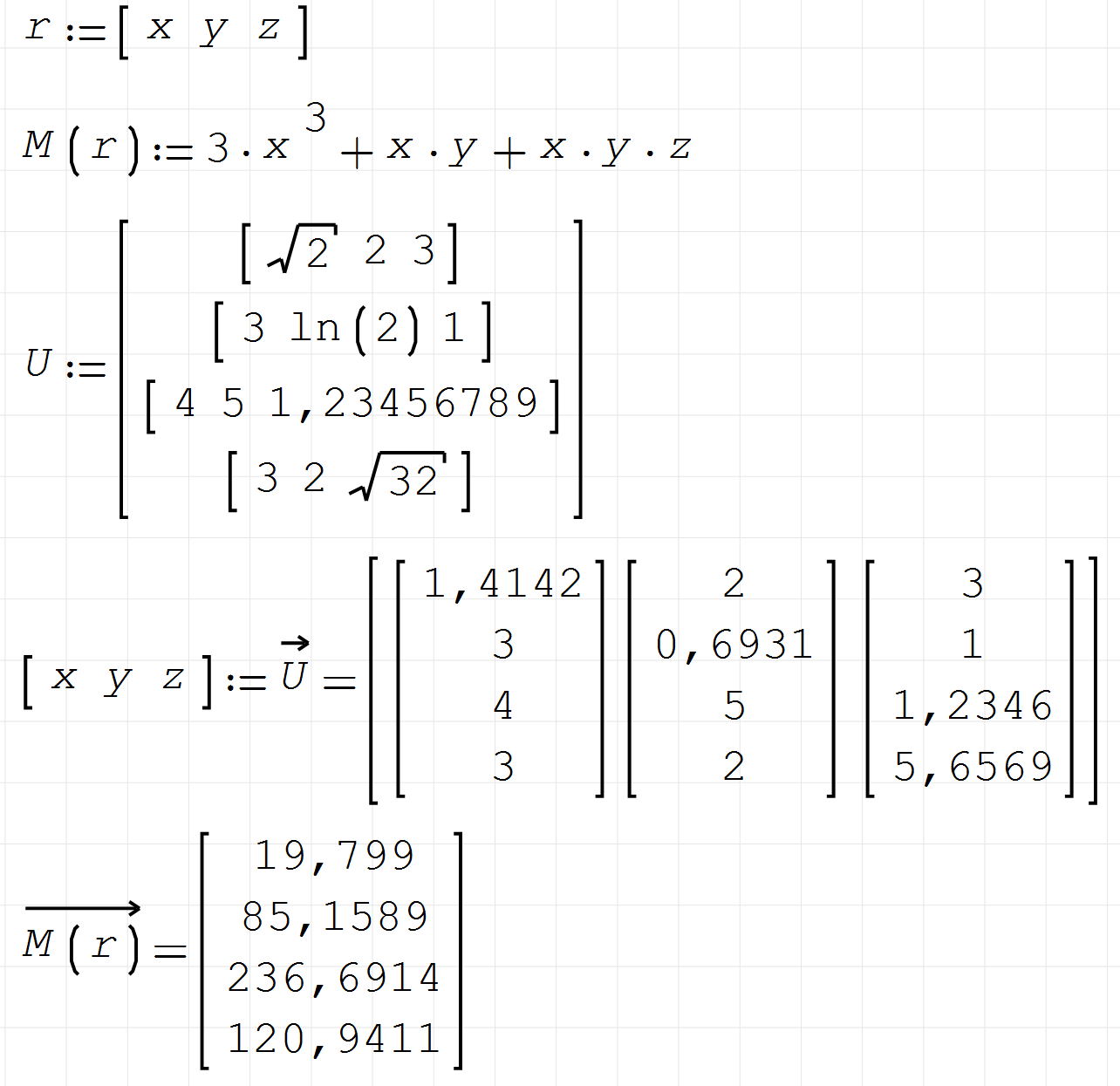

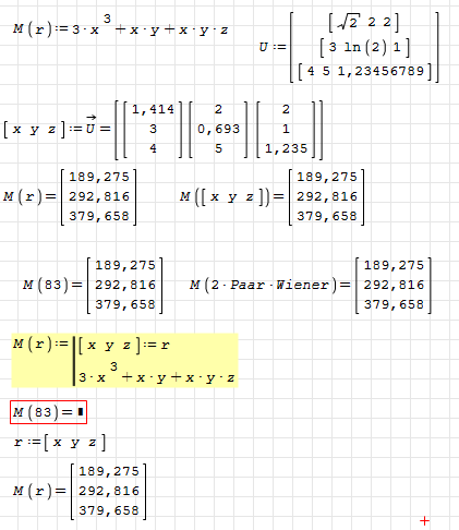

I take inspiration from Jean, but I use the Vectorize function and I forget the size of U
Show Spoiler
FunzioniVettori.sm (6.37 KiB) downloaded 1258 time(s).

Pay attention! The definition of M(r) doesn't make much sense.
#12 Posted: 4/13/2022 8:41:51 AM
Superb Sergio ... added in the main document.

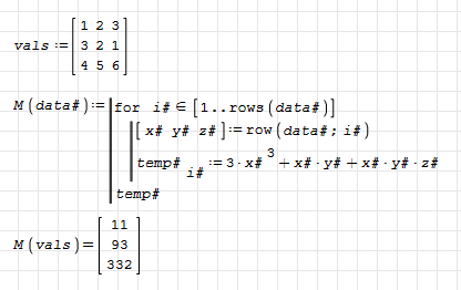

An algorithm can also be used.
It may be simpler by this way.
Worksheet1_algorithm.sm (4.69 KiB) downloaded 1299 time(s).

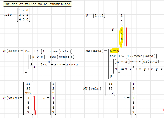

#15 Posted: 4/13/2022 2:48:08 PM
Martin_B
Martin_B
22 likes in 84 posts.
You should always define variables used as arrays in function before assigning elements.
Worksheet1_algorithm.sm (8.04 KiB) downloaded 1279 time(s).
sergio 4/13/2022 4:00:00 PM
#16 Posted: 4/13/2022 4:04:10 PM
Just a question, does the S variable had to be declared and dimensioned previous to its use ?
No, it sets by itself within the for loop.
Wise to clear within the algo ... U:=0
That will avoid interaction with else U above document.
Algo style is an immense companion in Smath.
Personally, I use it as much as possible,
it enables the local command line.
Cheers ... Jean.

#18 Posted: 4/13/2022 5:55:24 PM
Just a question, does the S variable had to be declared and dimensioned previous to its use?
It isn't required but it is good practice. If the variable name already exists you might fall in some unexpected cases when the dimensions are different. In addition to the above suggestions, you can use also a Clear(S) as initializer.
