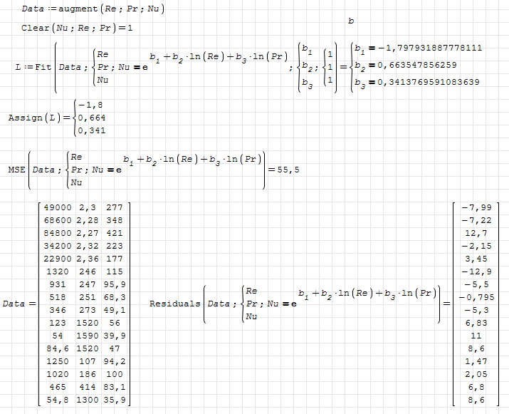

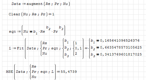

#6 Posted: 2/22/2019 3:05:36 PM
1,361 likes in 2,275 posts.
For example, like this one (also remained unsolved for me in SMath for years)
linfit_multiple-1.sm (22.94 KiB) downloaded 1314 time(s).
I don't know whether this counts as a reasonable fit, but at least you get a solution.
linfit_multiple-1_Kr.sm (162.77 KiB) downloaded 1282 time(s).
Edit: second example shows the same MSE, and nearly the same b2 and b3.

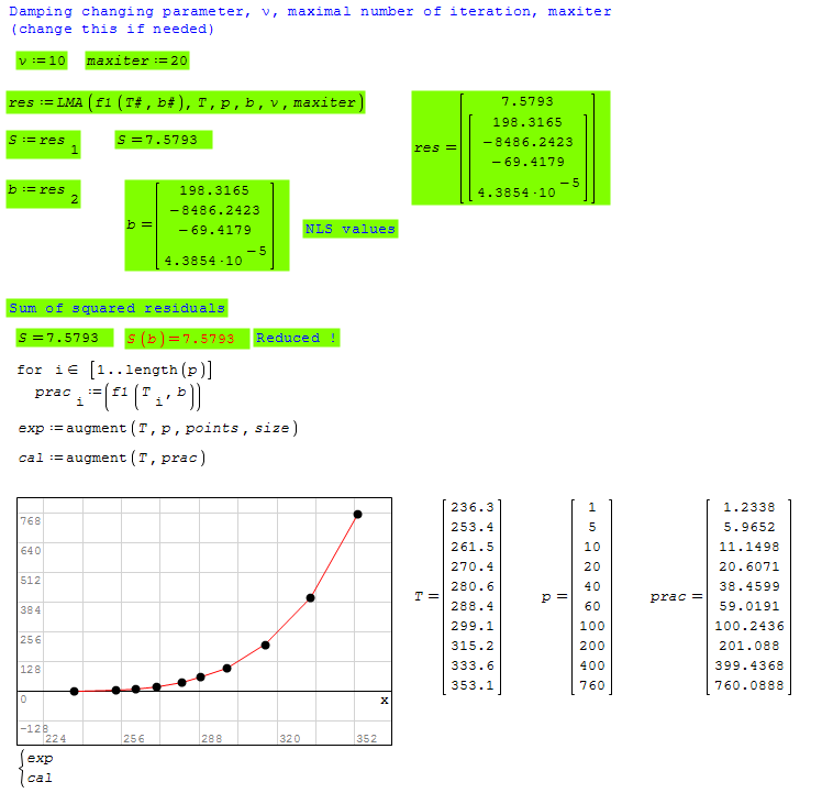

#7 Posted: 2/22/2019 3:10:36 PM
Hello Radovan, let me examine your unsolved examples.
... part 1 NLMinimization-9c doctors by itself
... part 2 LM complains ,,, not doctored yet
Thanks for this LM
NLMinimization-9c Scrap.sm (43.34 KiB) downloaded 1269 time(s).
#8 Posted: 2/22/2019 4:26:00 PM
Thank you Martin. It was a direct answer to my question - Fit() function from Maxima. Thank you for reminding us of this once more. Fortunately, we have Maxima plugin for nonlinear fitting (it slipped my mind) and I am glad that I was wrong. I also would have liked to be wrong by saying that this is the only function in SMath performing this task (maple plugin maybe?).
