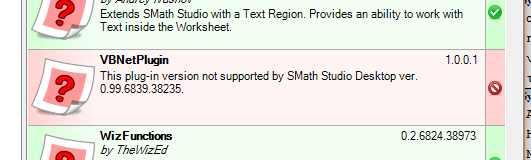

#4 Posted: 10/27/2018 11:00:16 PM
Basile
Basile
8 likes in 172 posts.
Davide,
This is what I have: It still persists every time I start SMATH.
Basile

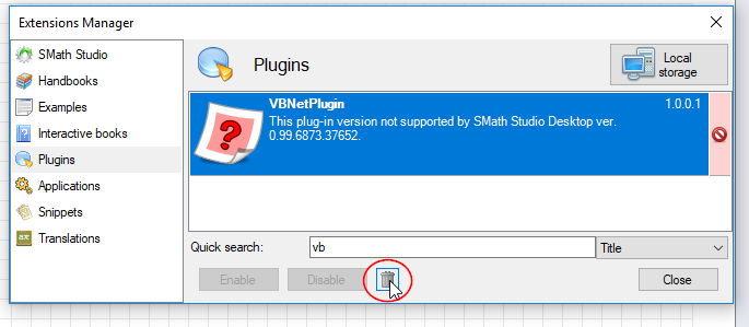

#5 Posted: 10/28/2018 6:01:34 AM
1,442 likes in 2,934 posts.
you can simply remove it.
#6 Posted: 10/28/2018 12:07:17 PM
Fixed, plugin recompiled. The plugin version was tied to a fixed value "1.0.0.1" that was causing issues on update logic.
