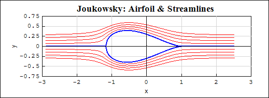

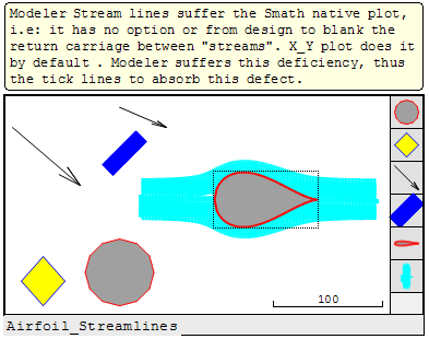

#1 Posted: 11/21/2018 2:00:11 AM

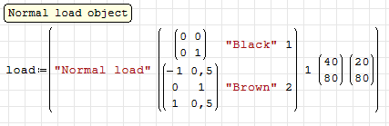

Hello Jean,
if you can extract each single streamline you can pack them in a single template without "return carriage", just like in the example provided by Andrey about the "Normal load" arrow, that it is composed by two lines (if you have the streamlines in a list/vector it's pretty easy to compose them with a loop)

Thanks Davide, will try ... after the sow job !
