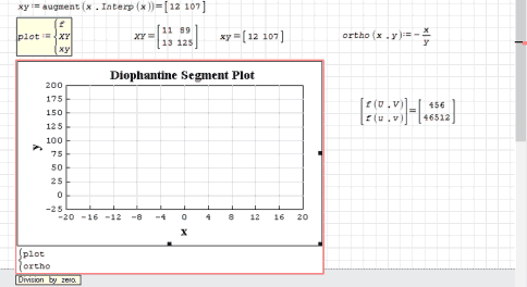

Maybe your work sheet needs be doctored as well as mine.
It happens, correct during the session of construction,
but fails on re-opening PC [little pest].
Solve Diophantine X_Y Plot.sm (25.08 KiB) downloaded 1158 time(s).

Hello Jean
Your file gives me the error of division by zero in the graph.

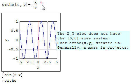

The module ortho(x,y):= -x/y may be the guilty. Try to remove it.

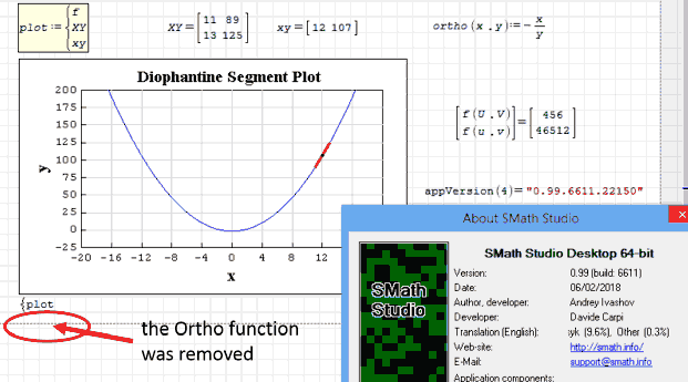

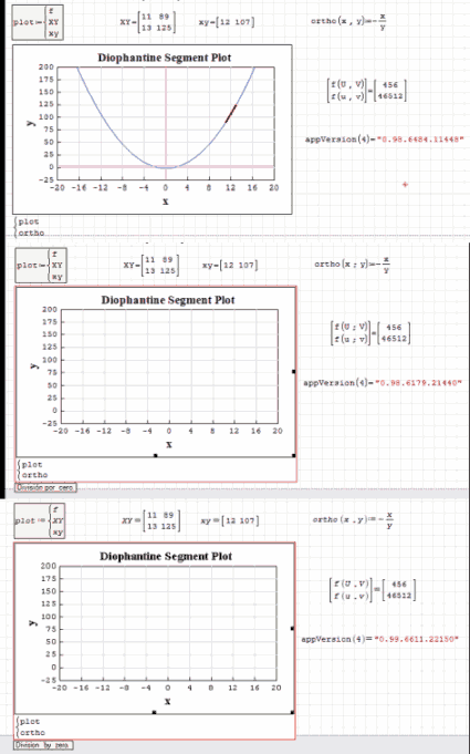

Hello Jean,
your file runs perfectly in the version of Smath Studio "0.98.6484.11448",
and fails in the versions "0.98.6179.21440" and "0.99.6611.22150", the error
is caused by the function "Ortho = -x / y". If this function is removed from
the graph, the error is eliminated, but only Parabola is plotted.

I have it the other way around: 6179 working great on XP Pro
6484 scrapped two work sheets, because I tried only two !!!
Whatever: there is a concurrent bug wrt X_Y wrt Smath versions.
Doctor one version, scrap the other one ... pest !

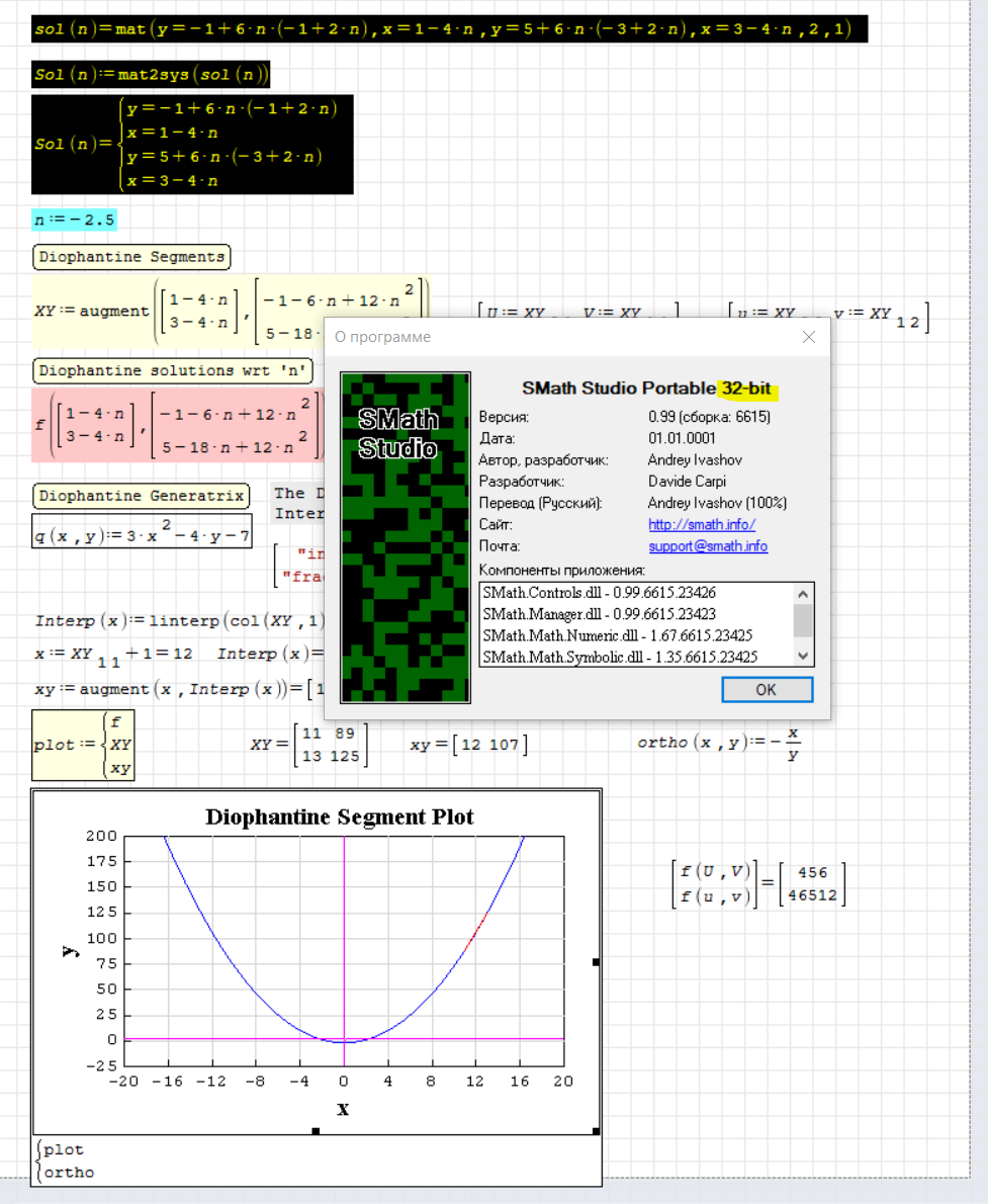

I would disagree with you. Beta versions usually much more unstable. But yes, sometimes I make mistake and build 6606 should not be marked as Stable, because I've missed something very important. But this is exception. F.e. latest stable is really good.
I have checked your worksheet and see question we have here is not about stable/not stable, this is about environment. I have checked different versions of SMath Studio (including 0.98.6484.11448, 0.98.6179.21440, 0.99.6611.22150) - error is shown everywhere.
Then I've tried to open SMath Studio in 32-bit mode and this helped! When it is 32-bit worksheet calculated without errors and graph is shown correctly.
So this is about 32/64 bit and present in all versions of the program.
(build 6615 32 bit = build 6611 64 bit)

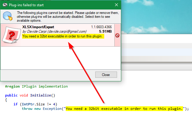

The bitness issue is typical of p/invoked libraries or external processes, something that smath can't manage automatically (except maybe introducing in the interface a flag that the plugin author can set manually to explicitly declare the plugin incompatible); however the developer can already throw an exception during the initialization to prompt the incompatibility to the user (mathcad efi f.e. has this check but it is suppressed in favor of his internal logger)
